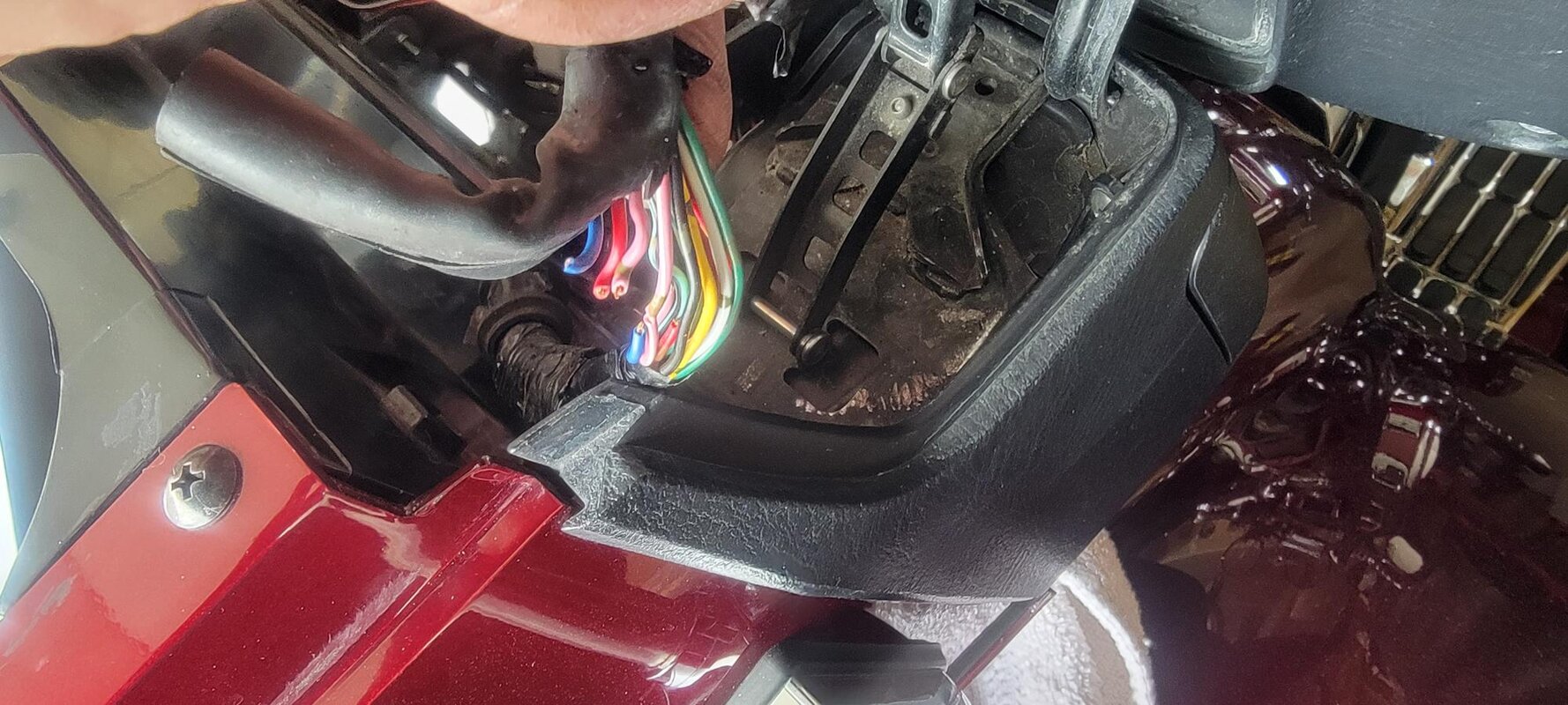

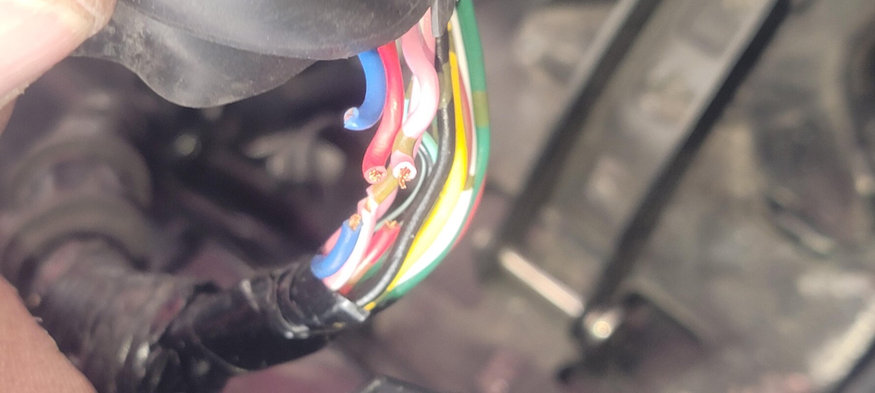

Anyone else have this problem? 2009 Goldwing with CSC Viper trike kit. Keyfob won't lock or unlock truck and tourbox. Lights blinks so Keyfob works. Trunk and tourbox lock when using key and locking on tourbox. Pretty sure it's something with the trike conversion. Recently accomplished.
Found the problem
Dadztoy, you were correct. Rt trunk hinge. Wires broken, see pics. Thanks
