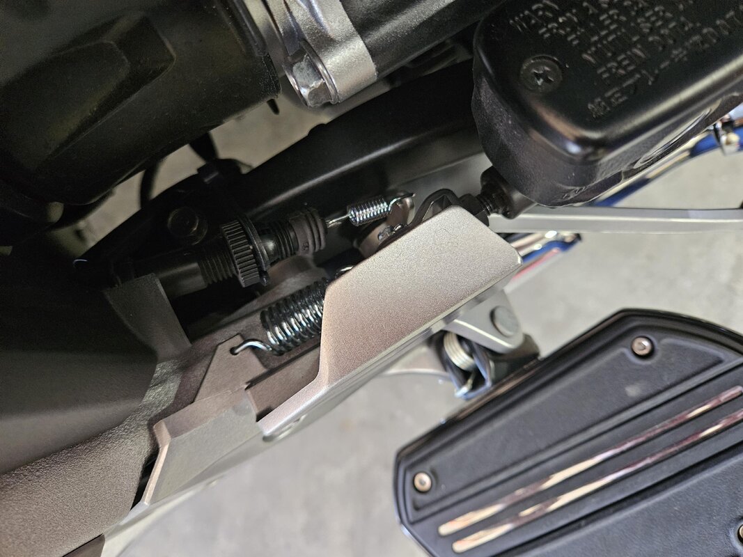

It’s easy to adjust that switch. But I wasn’t able to accomplish anything in the garage. The right rear light still makes the scratchy sound regardless of where I adjusted the brake switch. The right rear light assembly isn’t the problem, because if it was it would make the same scratchy sound when the front brake lever was pulled. I want to say that maybe that rear brake switch is bad…but why would that go bad because of the trike conversion. It worked fine before the conversion. I am assuming that since the “scratchy” sound remains that it still isn’t fixed. But I can’t know that for sure without test riding.
Can that rear brake microswitch be removed and cleaned? It looks like I’d have to remove the plastic cover (2 screws) and then there’s a “lock wire” that holds the switch to the plug.
I want to say that maybe that rear brake switch is bad…but why would that go bad because of the trike conversion. It worked fine before the conversion. I am assuming that since the “scratchy” sound remains that it still isn’t fixed. But I can’t know that for sure without test riding. Can that rear brake microswitch be removed and cleaned? It looks like I’d have to remove the plastic cover (2 screws) and then there’s a “lock wire” that holds the switch to the plug.
Mike,
The only ocassion where I have experianced the issue you described was corrected by adjusting the rear brake microswitch, but there may be some other cause.
I'm not understanding the "scratchy sound" coming from the light. Anyone have any thoughts on that issue?
I adjusted the brake switch, went on a 40 mile ride and it worked perfectly! I intentionally loosened the switch, probably more than I needed to, and will tighten it back up a little at a time and test ride.

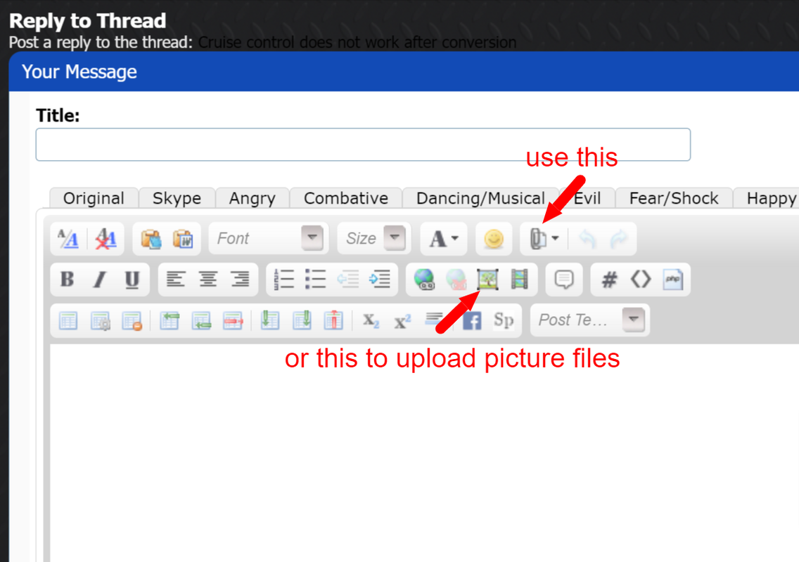

I would like to post pics but again, I have no icons allowing me to add pics or anything else.
I use Imgur - free photos. Put your pictures there. Once there, open the file and use post to message boards.
This works well for me.
