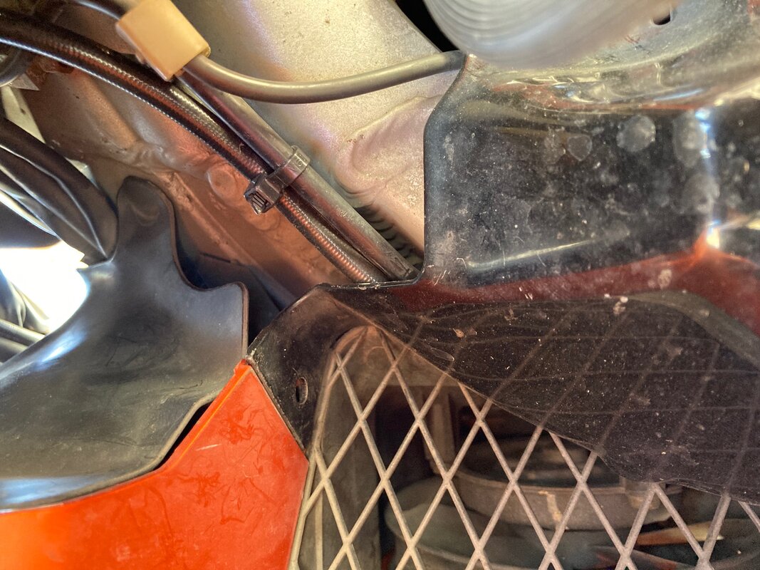

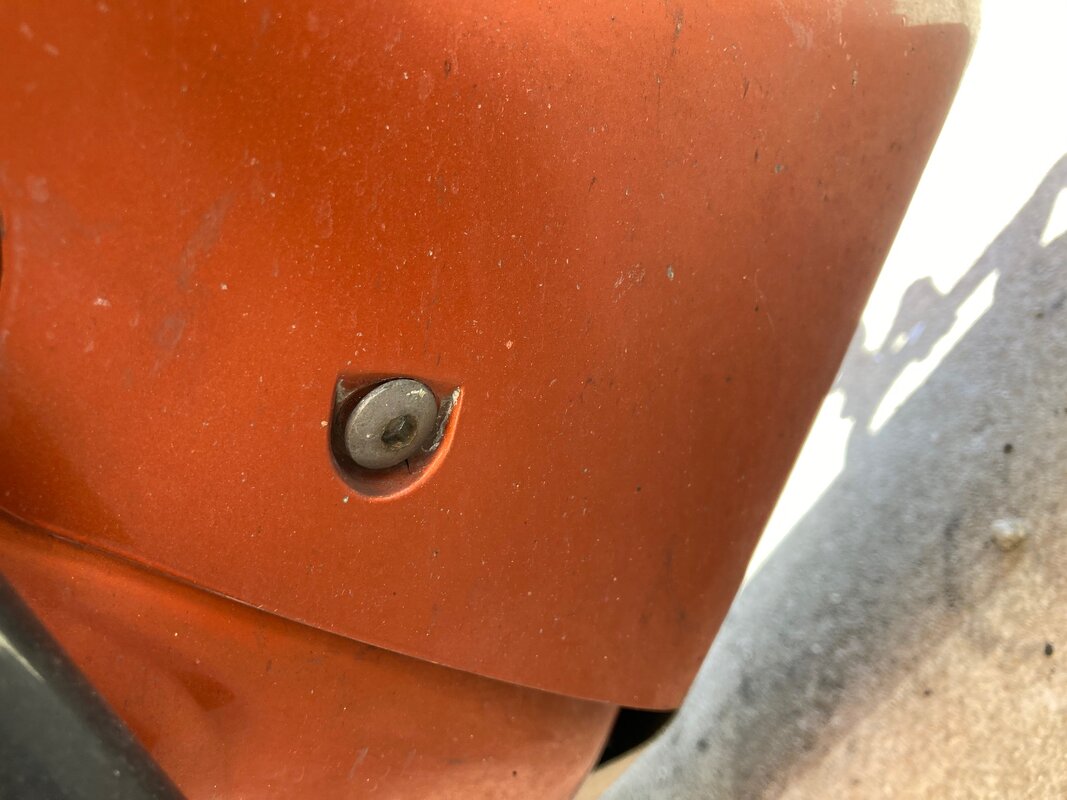

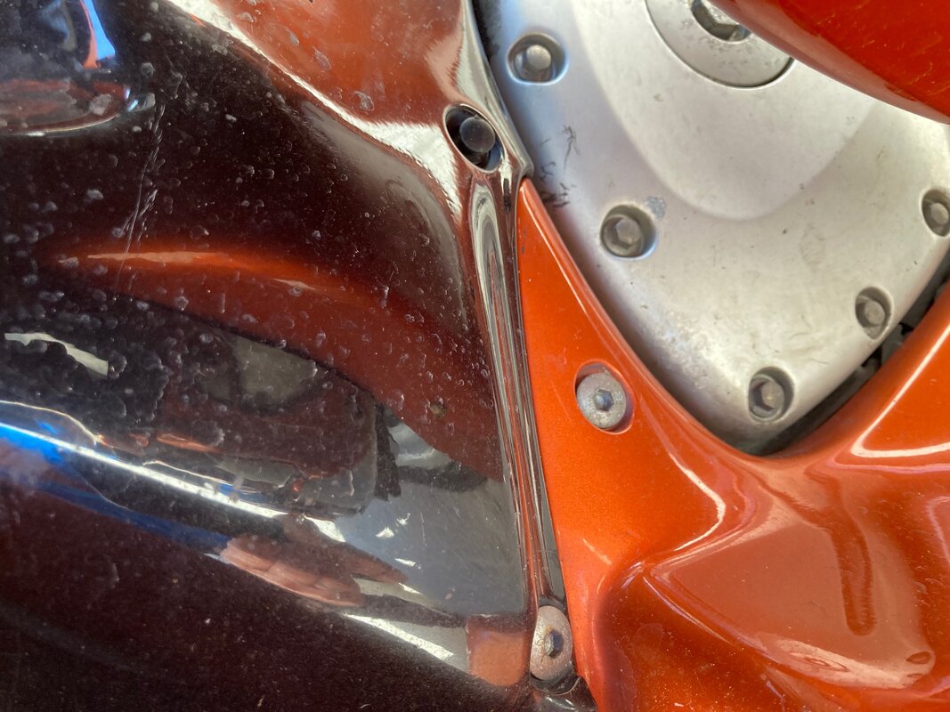

Hi can anyone help me out, the right cornering light on my 2004 Goldwing GL1800A trike is not working and I cannot figure out how to take it apart to check and see if the bulb is burnt out.:(

It's not too terrible to get to the bulbs but can be a bit tricky. you have to first remove the center black plastic panel above the chin panel with the lights, it has some plastic pins at the top and screws at the bottom to remove, then you can get to the screws to remove the chin panel, once that is removed you can get right to the lights, the hard part is moving the panels around so you can get to the lights, be careful, lifting the front wheel helps to get the panels out of the way as there a real PITA to get out off. as you can see one of my plastic pins is missing but you can see where it goes. you also have a couple screws on each side under the light to remove IMG_3313.jpgIMG_3314.jpgIMG_3315.jpg
