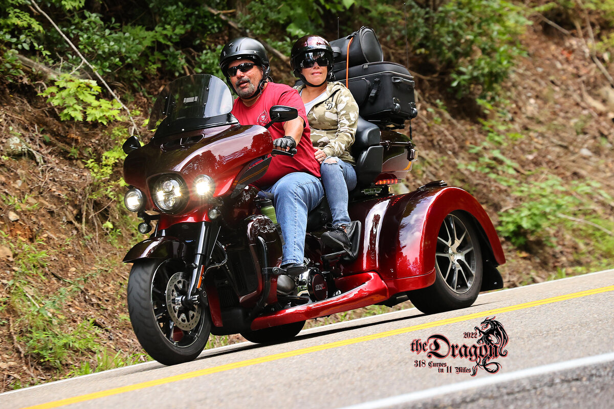

I agree with Cycle7447. W started with our beloved 2018 CVO Limited and had a Roadsmith kit added to it. I would have purchased a new TriGlide if only they came with IRS. Overall going the custom route was more expensive, but we got exactly what we wanted so we are not unhappy with the result.

Hey - let me guess - there are shoes in those bags. Good to see you back here. Wife and I are headed back to Milwaukie for the birthday.
