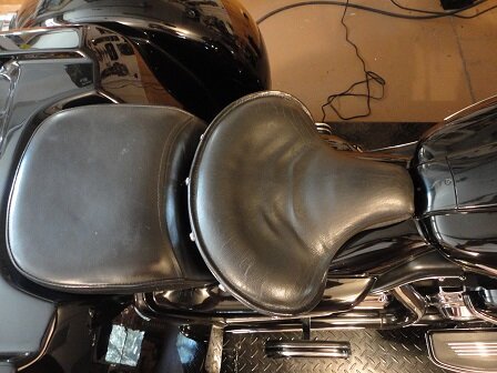

NOW, I like that. Have been toying with pulling my Tour-pak off but have been in a quandary about which seat to ride. Is that a police seat...?
Would love to see more pics especially the passenger area. I ride solo so not passenger provisions necessary.

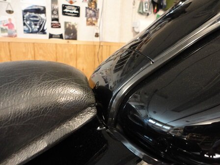

Be happy to oblige on getting you some pics and info on my solo seat. Pic #1 shows both seats. The solo seat is a Police seat swap meet find for $100. I did the rear seat as far as getting it ready for upholstery. Made the pan out of sheet metal and then started gluing on foam, then trim it to get it looking right (just use an angle grinder), then off to the local upholstery shop for the cover (they all know what to do) Money-wise I've probably only got less than $400 into everything.

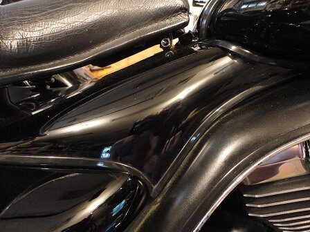

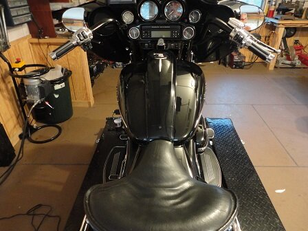

Pic #2 shows the view from the back. I went with a low profile dash plate for cleaner lines.

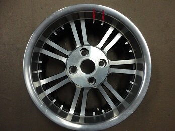

Pic#3 shows the fiberglass frame cover. I see J&P Cycles sells a few that could probably be modified but I like to make my own stuff, so out come the fiberglass & resin and a few weeks later... Ta-Da!
a frame cover with steel mounting pins where the springs go.

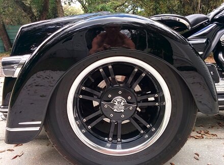

Pic #4 shows the details of the frame cover.

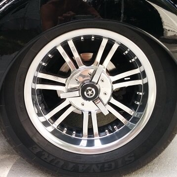

Pic #5 shows the dash extension that had to be made as well because a solo seat don't rise up to the stock dash and all you see is ugly wires and the dash bracket, so an extension is necessary to hide all that stuff.1.jpg2.jpg3.jpg4.jpg5.jpg

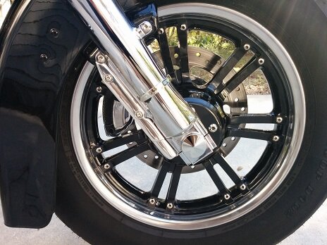

First I found a complete set of stock Tri-Glide wheels at a swap meet for $250, so I could work on them instead of mine so I didn't have any down time.
Then I found the right people to do what needed to be done to this set of stock Tri-Glide wheels. I found someone to grind all the little "accents" off each wheel ($600). Then had them polished locally (Daytona Beach) $200, Then a local powdercoater taped off the areas I wanted to remain polished and powdercoated them ($375), then I had the "hub caps" machined ($50) to hide the lug nuts, then I had the stock centers machined out to accept a skateboard bearing ($40), then I had small axles machined with a large flat area on one end so as to glue/screw any kind of do-dad onto it ($30), then I drilled very shallow holes on each spoke, deep enough for about 2 threads, and cut, screwed, and glued in polished stainless torx screws, then I drilled and tapped a number of holes in each "hubcap" and screwed and glued polished stainless torx screws in each hole, except one. Then I cut the tops off each lugnut so that the hubcap would lay flat, then drilled, and tapped one lugnut on each side so as to be able to use a torx screws on each hubcap to hold the hubcap onto the wheels. And what you wind up with is a unique set of "stock" wheels with REAL spinners that remain level to the ground even at 90mph! (sheesh! I'm all tuckered out!)
So to make this long story shorter.... they are reworked stock Tri-Glide wheels.
I originally removed the disc from the right side to see how it affected my stopping power and was pleased to find that the rear wheels do most of the stopping.
I have to exert a bit more force on the front lever to achieve the same amount of front stopping force but I mostly use my front brakes for around town cruising. I upgraded my rear pads ( I can't remember what brand) and they work awesome enough on their own, and now I can clean most of the front wheel from the one side... and it looks very cool (to me anyways). I didn't want to take the stock caliper mounts off so I made the piece of polished aluminum that bolts to the stock caliper mounts and they do a nice job of hiding the mounts. I do put the other disk on from time to time whenever I go on a long tour and am loaded up. Especially when pulling my trailer. The first picture shows a set of Harley wings with crossed wrenches. All items were found at the local Harley shop. The wings were easy to find and the crossed wrenches were part of a Harley key chain. The second pic shows some flying eyeball art from Ron Finch that I just mounted a few weeks ago.
The first set of spinners has over 10,000 miles on them and they still spin freely. Bottom line... the stock wheels offer great potential to be anything that you want. You can have them sandblasted and painted to match your bike or a combination of paint and polish. If I had to do it all over again I would just paint and polish because trying to get the powdercoating on without screwing up the polishing was expensive! So let your imagination roam, get some swap meet wheels, and have at 'er!
