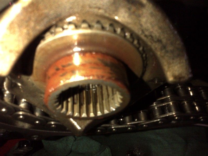

My was making noise under load..a bit different than what I been reading.. The rust I seen was inbetween the compensator plates..
Normally something like this picture is what folks have been seeing.
Mine was starting to look like that.. along with the plates.. Hope the new redesign SE version works..
