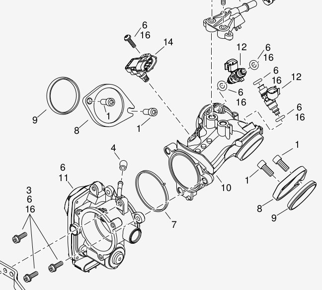

Are these the connectors your referring to?
No, the ones @ the Throttle body there should be a plug in, similar to this
