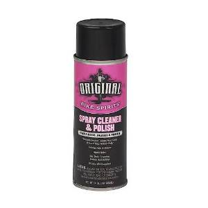

I use the old Honda spray cleaner on mine. Seems to shine as well as anything. Aluminum is a bear unless you keep after it.
At one time I also used the Honda cleaner/polish. Some time ago, Honda changed vendors and the formula changed!
All of a sudden my dark red Wing was almost impossible to keep from streaking when using the Honda product!
Asked the Motorcycle supply store I use what was going on and they told me the above info and introduced me to the product I pictured above, telling me it was the old Honda forumla being marketed by the former Honda supplier!
Been using it ever since.
Wash my aluminum wheels and use it and they shine like new. My wheels are not clear coated.
