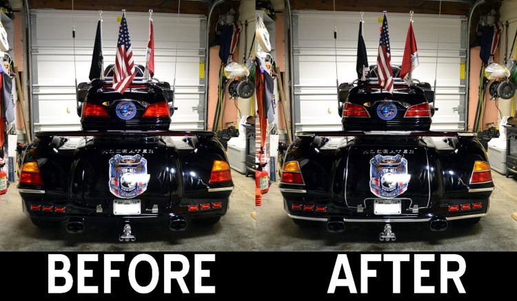

I headed over to the local auto parts store and picked up some of that flexible chrome that's usually used for door guards.<br />
<br />
Two different sizes. Some went on the Whale Tail and the rest of the thick stuff I ran along the bottom of the back by the mufflers.<br />
<br />
The thin stuff I used to go around the taillight lenses for a little added touch.<br />
<br />
All of this cost less that $25.00 and was very easy to install. I just had to use denatured alcohol to get the paint clean enough for the double-sided tape to hold securely.<br />

Thanks! I was hoping that it didn't look like I got too carried away with it.<br />

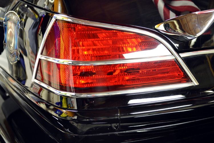

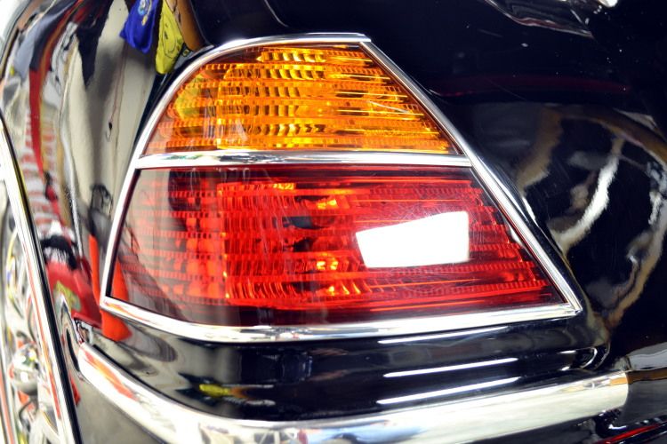

These are a couple of close-up shots of the upper and lower taillights.
What did you use for the smal lights above the mufflers? Are they LEDs? Will you post a cloeup picture of the small lights. Thanks, that looks good!
I believe there is never enough lights on the rear of a trike so people can see you.
