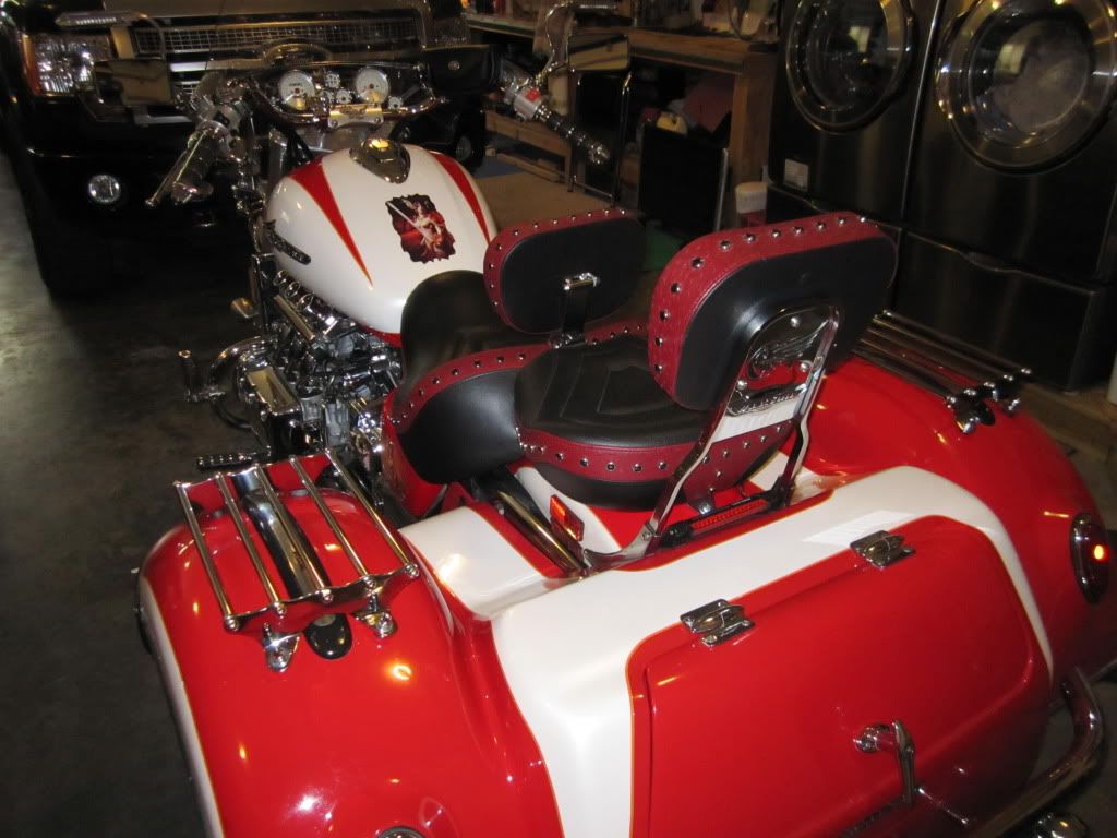

Well, I finally got both of the fender racks installed. Now mind you, all I did this weekend was finish installing these racks and I put a new bar-b-que together. I feel like someone beat me up with a lead pipe! I'm so damn sore I can barely straighten up. Needless to say that's why these 2 photos were taken in the garage instead of outside. I had all intentions of taking her for a ride especially with this beautiful weather. In any event, here's the photos;
