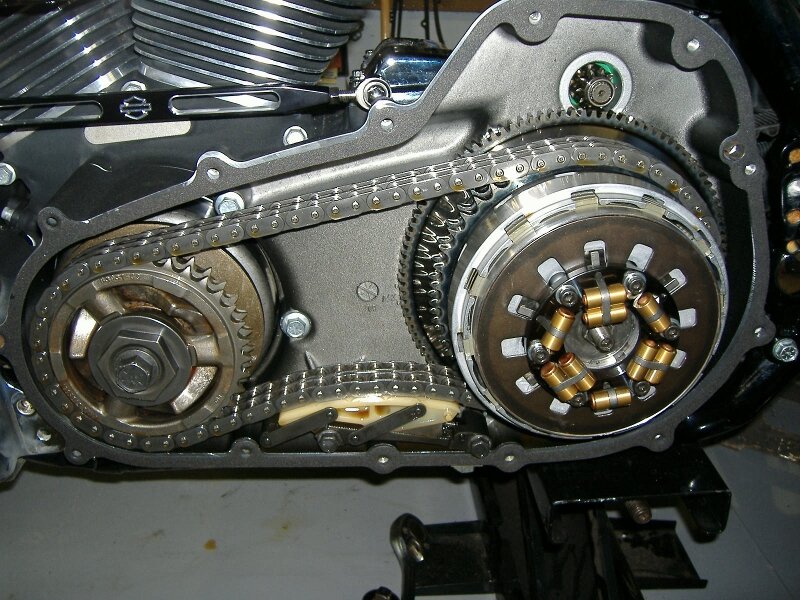

Picture of the primary chain before I removed the tensioner.

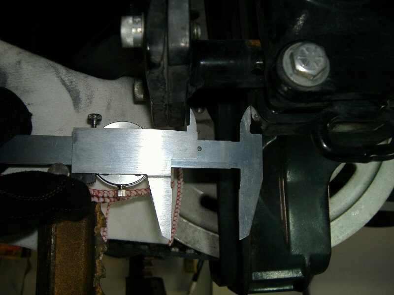

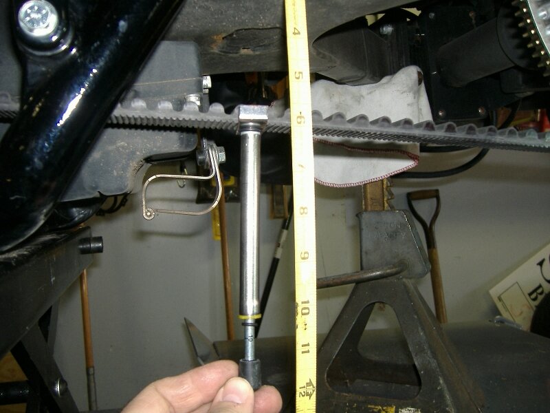

Zip tied the tensioner in place per the manual, I'm of the school the more zip ties the better. The tensioner wear pad is in pretty good shape. Only thing I don't like is the chain was tighter than it should have been, only had 1/2" of deflection.

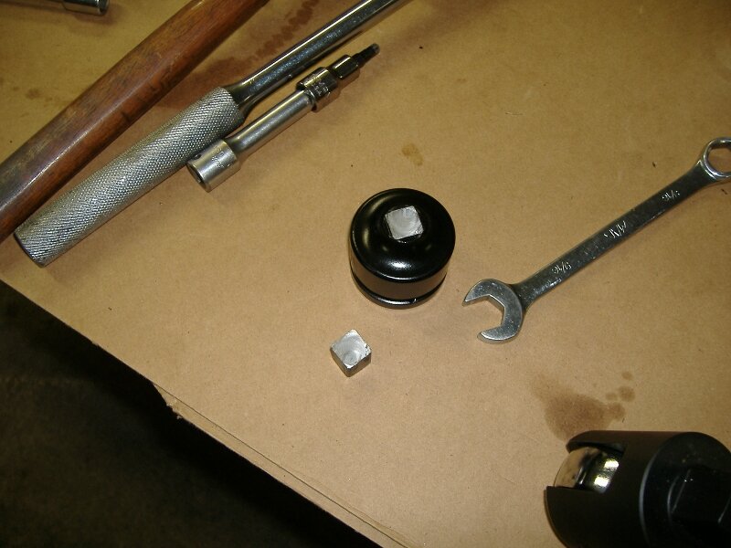

This is a picture of the compensator sprocket and ramps. I was interested to see how the sprocket would look. There had been guys seeing some gulling where the ramps run on the sprocket, mine is showing some of this gulling.

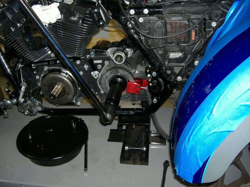

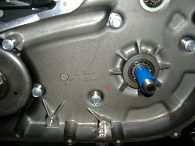

Shot of the primary with everything removed.

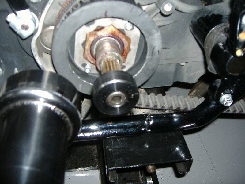

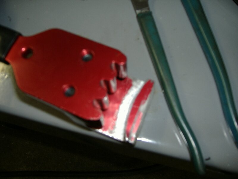

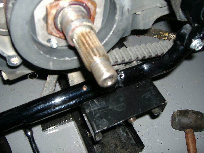

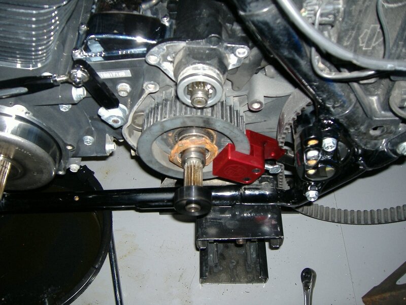

I started by loosening the belt, taking it off the sprocket and removing the lock plate. This is a shot of the plate being taken off and the transmission sprocket locking tool installed.
