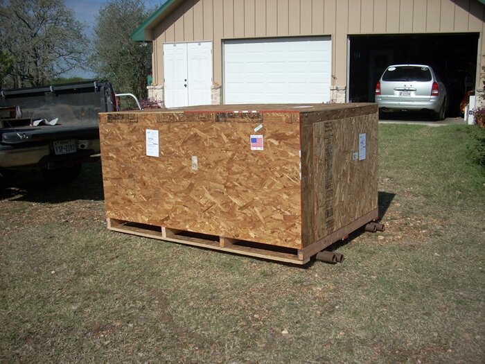

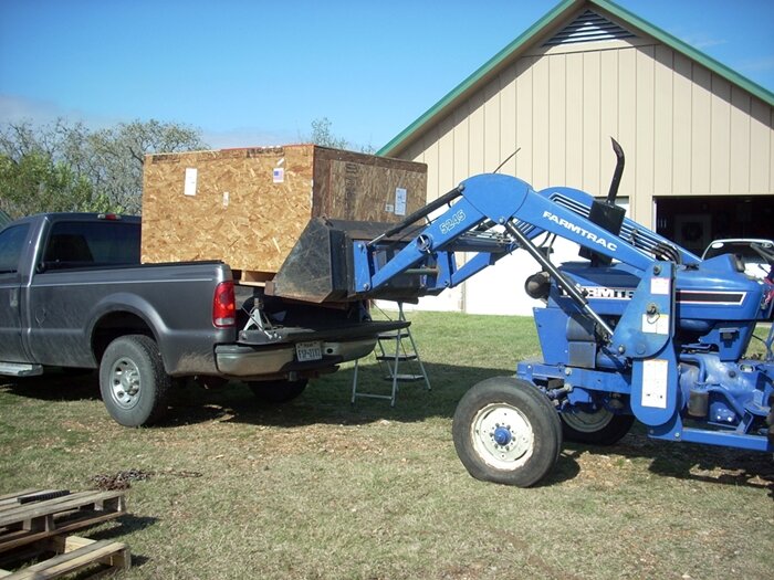

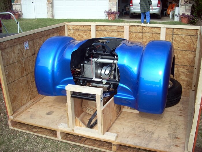

Un-crated our Champion Kit for the 2009 Kawasaki Voyager
Our Champion trike kit finally made it to Texas, last Tuesday. Selena and I drove to San Antonio to pick it up, then left for the DFW area on Thursday. We got home yesterday, so I was finally able to unload it from the truck, and crack it open.
All was in great shape, and we were able to get it all un-crated and moved into the shop. Good thing, the rains moved in this afternoon. :-(
My plans are to photo document the entire build. The instructions can use some help, so I'll be working on an addendum too.
Gotta admit, Champion makes a fantastic kit.
Shin

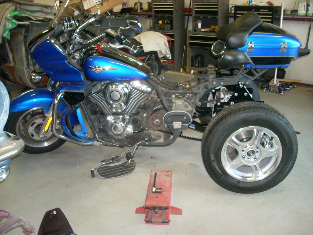

Since we got back from our "Christmas" trip, New Year's weekend, I've been working on the Voyager conversion, around all kinds of other stuff, and have made pretty good headway.
I've got to do more tweaking on the left exhaust, but have to wait until the new muffler gasket comes in. The right one was re-usable, but the left one is stuck to the muffler pipe, that had to be cut off.
So far, the kit's been an easy install, and I've only had to open up two bolt holes. I did have to grind powder coat off the ends of the "Swin Arm," so it would fit between the frame.
The kit was supposed to come with trailer wiring, as I ordered the hitch kit, but it's no where to be found. Luckily, I had been towing a trailer already, and have trailer wiring that will work.
Right now, I need to bust the rear brake system apart, and install the new brake line. I've been avoiding it, as I HATE working with brake fluid. Oh well, that's my To Do list, for the day. :)
