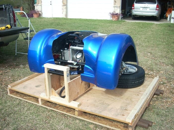

Howdy All!
Been plugging along, on the '09 Kawa Voyager conversion. I'm really pleased with the Champion kit. Very few issues, other than having to enlarge a couple of holes in two small parts, grinding the powder coat off the ends of the "swing arm" where it fits into the frame, and no trailer wiring, although I ordered the trailer hitch kit. I have wiring on the bike already, so it's not going to be a problem.

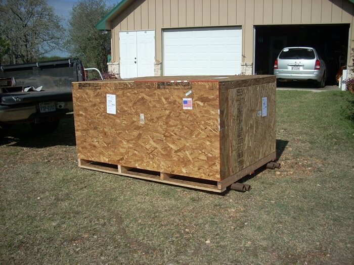

The kit arrived in a fantastic crate, very strong and everything securely fastened down.
Only other down side, the hardware bags are not identified, so I had to identify them by the list of contents. Works, but would be nice if the bags had letters on them, to match the letters on the list.
The parts, and engineering, are awesome. I understand the cost, now, and am glad we went with the Champion kit. I've been enjoying bolting it together.
I've got to finish "Tweaking" the left exhaust, but have to wait until the new muffler gasket arrives. Couldn't use the old one, as it won't come off the piece of pipe, that I had to cut off of the muffler, for the extension.
Oh well, I have the rear brake circuit to tackle. I've been avoiding that, as I hate working with brake fluid. :mad:
I've got a BUNCH of photos in a Flickr album.
All the best from Sunny South Central Texas!

Last week, I backed the Blue out of the shop, planning a little test ride, up the driveway and back. Wrong! I couldn't keep her in a straight line, as the front end wanted to flop hard to the left and right. This was without the body work, but I figured it wouldn't make any difference.
Turns out, the rear tire pressure did. I didn't think to check what the were at. Turns out, the arrived at 35 psi, the mounting pressure. Champion's instructions say run them at 20 to 25 psi. I dropped them to 20, which lowered the rear end by 1/4" and all is good.
Mama and I hopped on and rode Blue up the road and back, with no issues, other than she rides a bit rougher than on two wheels. Now if the replacement residual valve would get here, I can finish the brakes then get the bodywork in place.

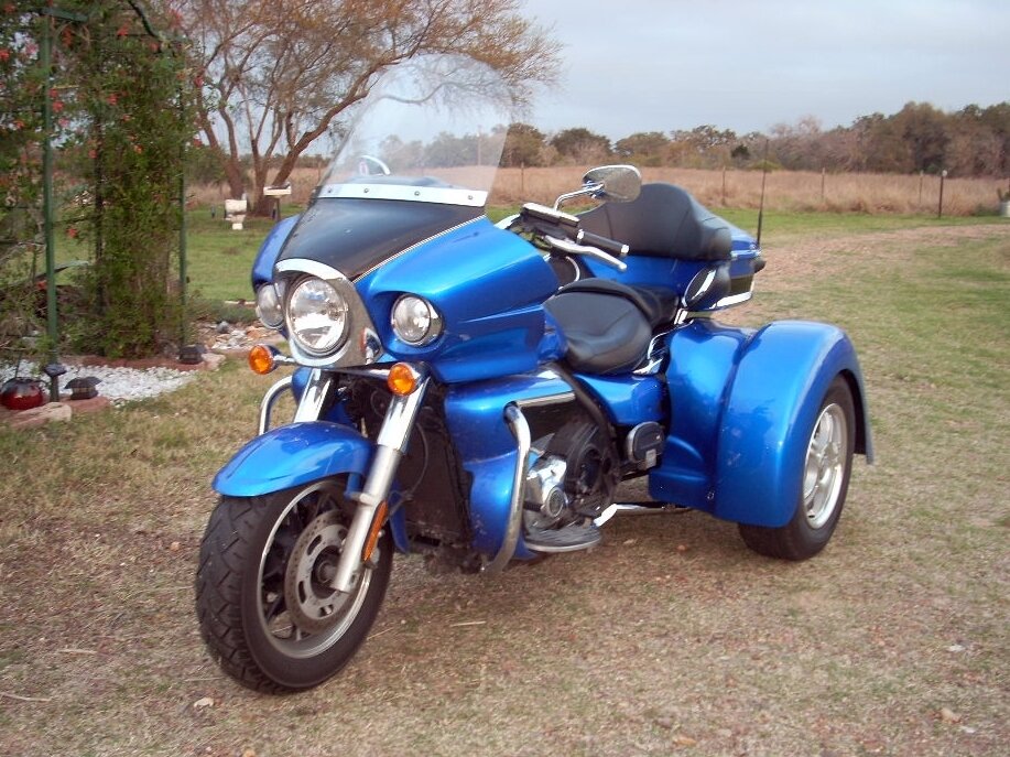

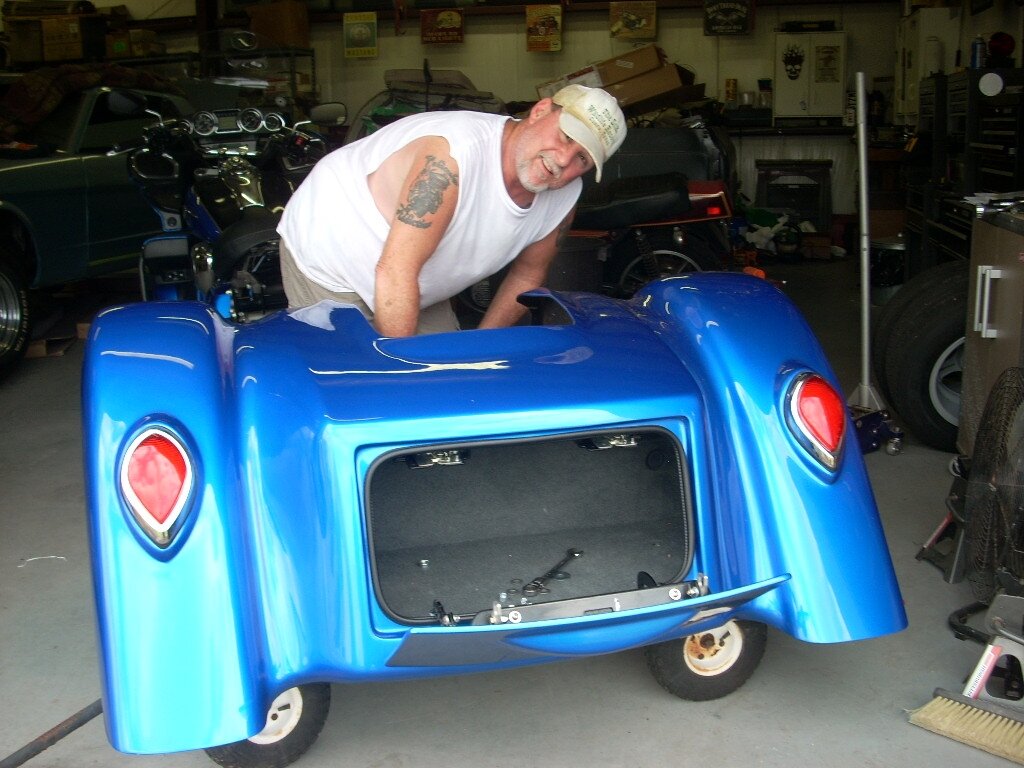

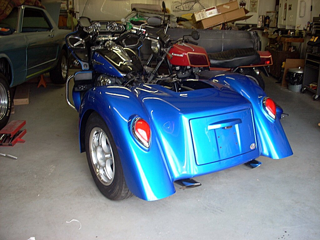

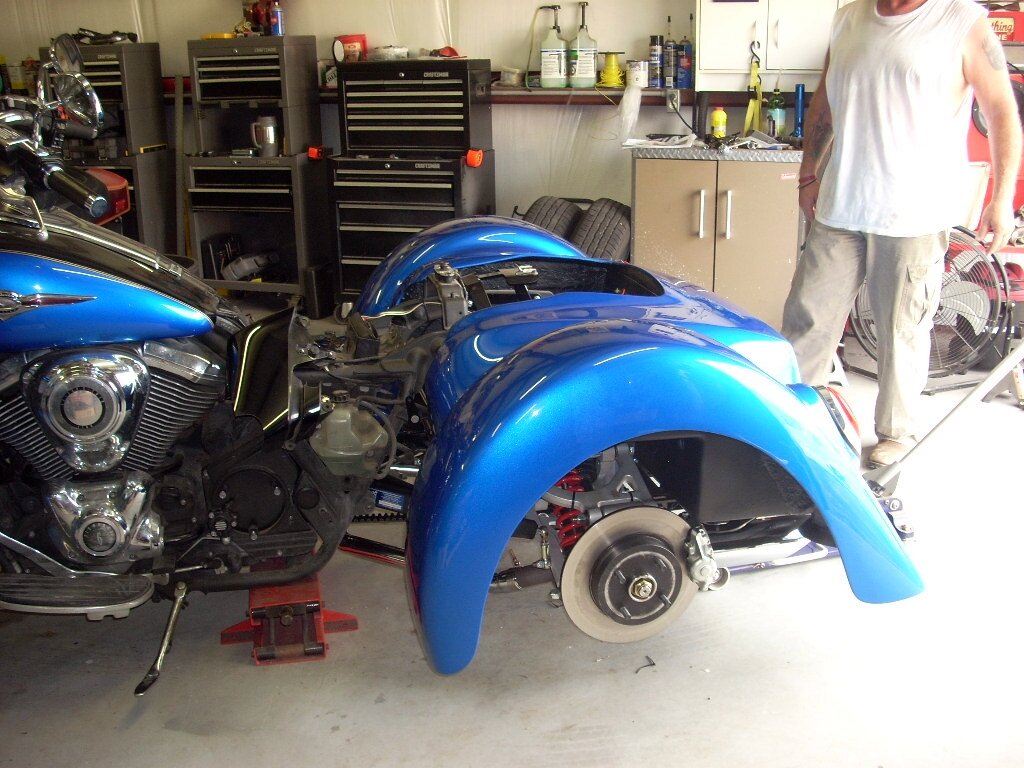

Got Blue's "Butt" installed!
Rear brakes aren't great but combined with the front, the bike is safely stoppable. Good day to install the rear end, so with Selena's help, we got it installed. Pulled the rear wheels, lowered the bike as much as possible, and Selena and I were able to lift it up and over, then down.
After everything was buckled down, I temporarily installed the plate and went off for a ride. Very nice! Lowering the rear tire pressure made all the difference in rideability. I'm okay with the bar pressure in handling. Don't think I'm going to spring for the raked trees. Gotta get the touring trunk reinstalled, and we're going for a little ride. DSCN0032.JPGDSCN0033.JPGDSCN0034.JPGReady for some adventures!
Shin

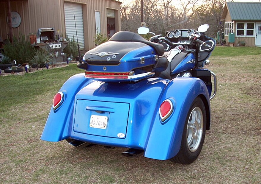

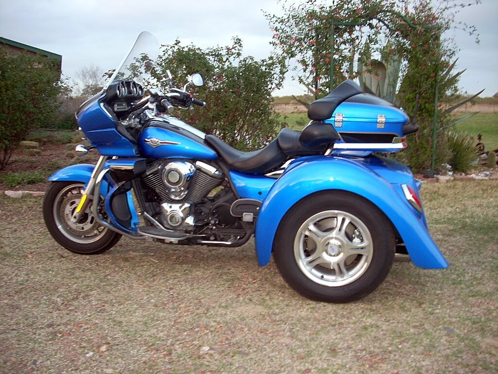

A few little things to tidy up, but here's Blue with "Training Wheels!"
Got the Tour Pack (trunk) installed today. A few little things to dial in, but I've got about 75 miles on Blue, without, and now with all the body work. I'm VERY pleased.:pepper: Wife, Selena, says Blue has the sexiest ass ever. :laugh: Looking forward to many adventures.
Thanks to everybody for helping make this possible, and for all the encouragement and advice. So, when will there be a Hill Country get-together?
Shin
