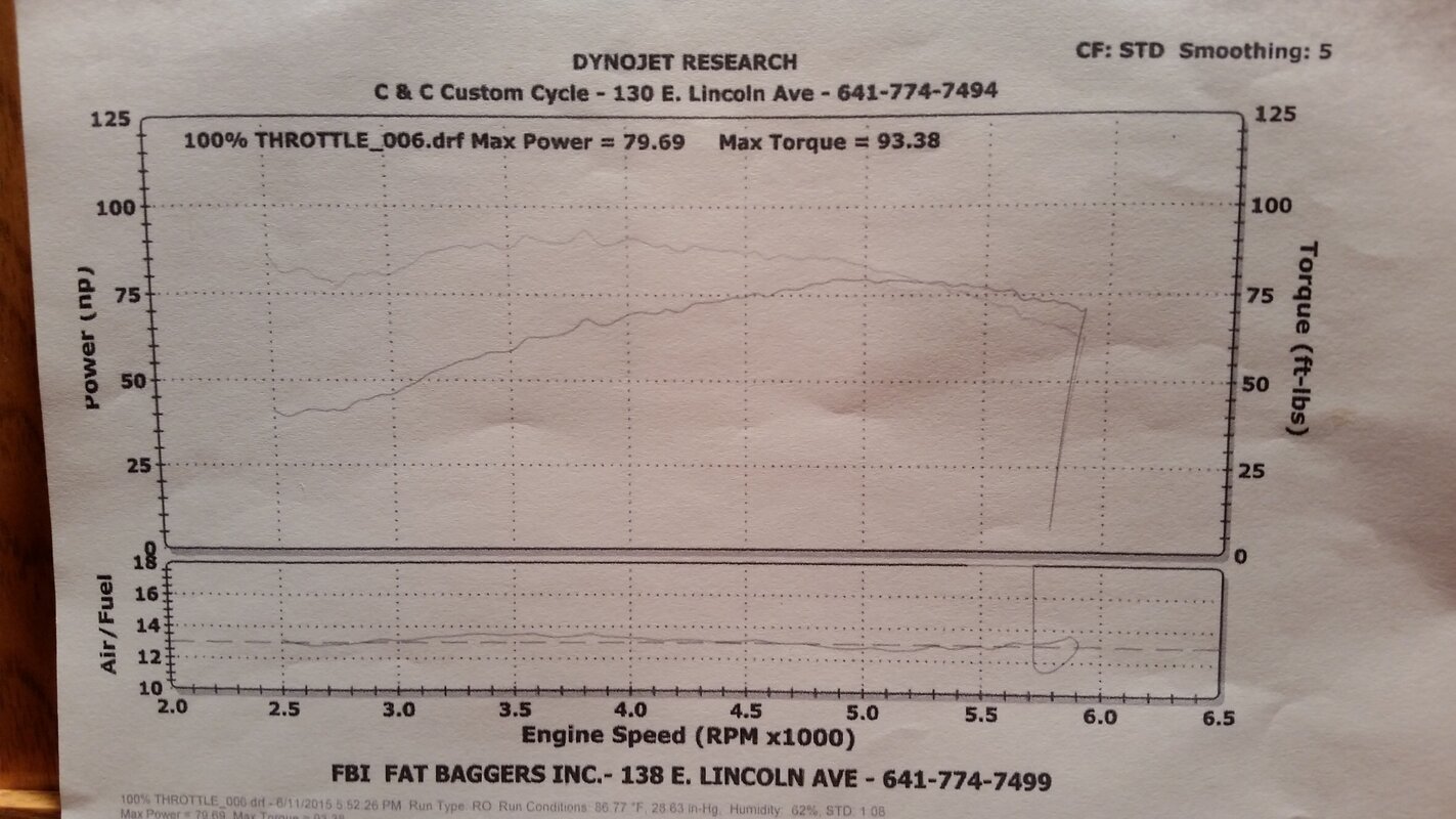

I talked with the dyno person. He explained how the dyno is more accurate than a person and it will create its own mapping, didn't really give me a map. I saved the map from the pcv and will try to post. The ignition is the same on both cylinders.
I'm going to make an assumption, the base map in the ECM is a stage 1 for the 103. With that assumption, and considering it is now a 106 with cams and much better flowing heads, I think your tune is jacked up. Who ever tuned it gave it a lick and a promise. Some of the reasons I think they didn't do it right are, from looking at the screen shots you provided in the other post. I would have expected to see more fuel adjustments across the whole range, the 2nd thing is timing. They could have split the timing into front and rear, you don't have to have just one timing table for both cylinders. The front and rear cylinder never have the same timing curves, to do so from a tuning stand point is just lazy and doing a half assed job.
I'll bet the person who tuned it has maybe 2 hours tops in that tune, if that. To tune that build properly it should take around 4 hours or more. The last time I saw a 2 hour wonder tune, it pinged and ran hot. The person who tuned that left power and torque on the table, someone who knows what they are doing, and wants to do a good job will get more out of that build.
I'm not sure who the tuning dealer is, I see a couple possibilities if you want to check them out. http://www.harleyofmasoncity.com/ http://www.mcgrathpowersports.com/

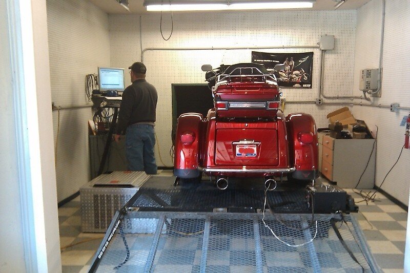

According to Dynojet all 3 have a Trike dyno which is the DJ250ix. If you would talk with McGrath or Top Gear, I would ask them how many Harley Twin cam bikes or trikes they have tuned. You want someone who knows how to tune a Harley.

V&H true duals are terrible pipes, they are bottom end torque killers. The best that could be said for them is they are noise makers. I had a set on an 05 Electraglide, after about a month I took them off and sold them on ebay.
The question you should ask the dyno guy is, why wasn't timing optimized when he was tuning it. A complete tune is more than just setting AFR, it includes timing, and other table adjustments if available. Since you have the PCV, the only thing they can adjust is timing and getting the AFR set right. Also sometimes advancing timing actually cost torque, the tuner has to play with it. He has to advance it and see what happens to the power and torque, then take timing away if advancing it didn't improve things. Like I said earlier, the guy who tuned it gave it a lick and a promise, they shouldn't charge you for something they didn't do right the 1st time.

The Dyno numbers still seem pretty low to me!! I would think with your configuration you should be closer to 100/100 or a little more!!
However, if your "seat of the pants" dyno is happy/satisfied that is all that really matters.

The Dyno numbers still seem pretty low to me!! I would think with your configuration you should be closer to 100/100 or a little more!! However, if your "seat of the pants" dyno is happy/satisfied that is all that really matters. Good luck with your ride and ride safe!! Roger
I'd expect a little more torque, especially since its a 106 with heads. I got better numbers from a 103 with just a set of Wood TW555 cams, I think a 103 with the TTS-100 cam would make better numbers. Something is missing, great its running better, but something is missing. Will be interesting to see the dyno sheet.

The dyno sheet I received is in mph not rpm. I have a call into them to send another haven't heard back yet.
Because its a trike should the numbers be 15 to 20% lower? Another wheel on the ground?

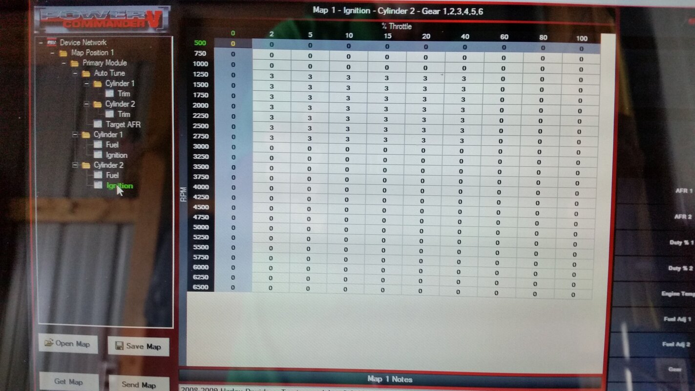

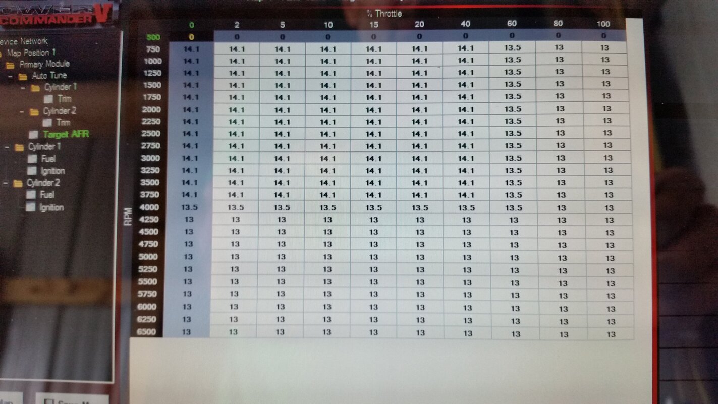

I also haven't looked at the map on the PCV. Timing etc. Ill look at that also.

I did look at the ign timing, where it was -4 on the cylinders it is now 3. Both cylinders are the same.

Any Dynojet DJ250ix should hold your trike, I can't help but feel you have a 2 fold problem going on. One is the folks tuning it, the other is the tuner. The PCV isn't the best for larger than stage 2 builds, yours is a bit more than a stage 2. Here are a couple dyno's I found kind of close to you.

This is my dads 09 Triglide on a DJ250ix, there is room to spare on the drums.
I would think that would determine who did the tuning.

I primarily tune with the TTS, I've used the SEPST a little. I've also worked with the PCIII and the PCV, I've just been underwhelmed with them.
Yes the OP needs something done. That is really low on HP/TQ. My stock 103 free as more than enough power as compared to what he has posted.

I am thinking he has some bad head work done, with a bad tune. When building a engine you have to look at one direction. HP or TQ not both. If you build it with TQ in mind the HP will be with it, just a lot more TQ than HP. With a lot of new cams available it's hard to do a base build knowing what the results will be up front. My 113 was built for TQ but got 124.8 HP and 148.7 TQ. I am using the ss585 gear cams but the TQ came from the heads a low end. 108 TQ at 1,500 rpms.

When they dynoed the last time, it was with heritage mufflers and CSC mufflers.
The heritage dynoed better than the CSC.
Could be both are a restriction.
This is still the best it has ran since triked.
Could be valve train noise I'm hearing. I'll let someone smarter than me listen.
I called these plus a couple others but still haven't found someone else to dyno.
Actually top gear never answered but McGrath hasn't heard of them.
I feel like they are getting closer on the tuning but not there yet.
This is
where it is now. Before it was -4 on the tuning and now a 3. As Steve pointed out the AFR is lean from 2800 - 4300 rpm. When looking at the target AFR the 14.1 seems lean. I can adjust that and the timing but I'm just guessing. Is this where a different tuner other than PCV comes in?
I will ask C&C about the AFR and timing.
It does appear their not going far enough but I'm not a tuner.

The difference between the PCV and a good flash tuner such as the TTS is the ability to choose and modify a base map more suited for the build.
The PCV just connects between the ECM and the harness from the ECM and modifies the signal coming and going, more or less it tricks the ECM to thinking things are different than what they really are. The timing is a shot in the dark, when you look at that 3, it is the PCV adding 3 to the timing that is contained in the base map in the ECM. That map could be the stock engine map, or it could be a Stage 1 map.
One of the biggest problems you have is the dealer doing your engine work, has turned it into a science project. Which is a miss mash or pieces and parts that don't necessarily compliment each other.
I feel like they are getting closer on the tuning but not there yet. This is where it is now. Before it was -4 on the tuning and now a 3. As Steve pointed out the AFR is lean from 2800 - 4300 rpm. When looking at the target AFR the 14.1 seems lean. I can adjust that and the timing but I'm just guessing. Is this where a different tuner other than PCV comes in?
If your willing to adjust on the PC-V yourself the worst you will have to do is put the old settings back in it if you do not like/feel how the changes you make did. Just save what's in it now and add about 5% more fuel to the WOT area from 2800 - 4300 in both cylinders. Only do one change at a time and then test ride.
If it improves it then you know to continue with it, if not go back to one step before another change in tuning.
TAKE YOUR TIME WITH IT.
I would also look at adding 5% more fuel down below 2100 RPM as a second test. Remember these are WOT changes NOT everywhere This is because they did not seem to run the testing down at low RPM and I would rather have the engine to the rich side for this type of butt dyno tuning testing. Once the fuel seems to have no effect back up to the one before and then you would switch to adding a few degrees more timing and then pay attention to the trike. If you here pinging back off the throttle, and take it back out again in the RPM area your heard it. Its kind of hunt and peck way of doing it, but thats all you have in your position.
