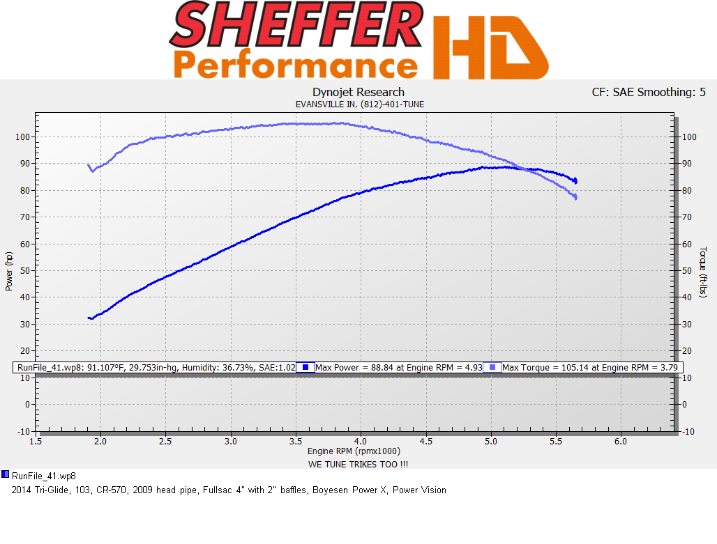

2014, 103", Tri Glide with Cycle-rama 570 cams.
This trike also has a de-catted head pipe, Fullsac mufflers with 2" baffles and a Boyesen Power X air cleaner. Tuned with Dynojet Power Vision.
That's a really nice torque curve. Very flat & similar to what we're seeing on the M8's.
My '14 with a Performance Plus Stage I is the same peak torque at just under 106 ft. lbs., BUT it does not cross the 100 ft. lbs. until a bit after 3000 RPM's. Yours is bumping 100 at about 2300 RPM's. Nice job!
Thanks Kevin, these Cycle Rama 570 cams are the best bolt in cam for a 103 I have tested to date.
In 2 wheeled applications they cross 100 tq before 2000 rpm, and peak around 98hp/114tq.
Daren

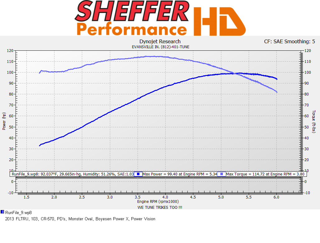

Here's an example in a 2013 Road glide.

Below is a Customer of ours that took his bike up there for tuning. He also has a Power Vision, along with our 636v and a bunch of other goodies.
Power does not come on as low, but when it does, it is strong!
