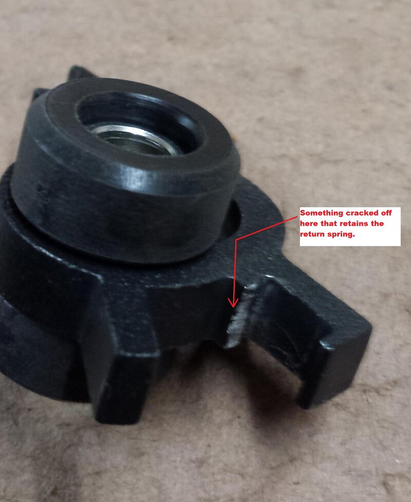

The parking brake pawl (ratchet mechanism) stoped working the other day. I push down on e-brake pedal and no clicks. It springs right back up.
I could not get the small spring to clip into it so I removed the pawl to find a piece cracked off. Dealer ordered me a new one under warranty. P/N 83000018
Bob :Dorag:
