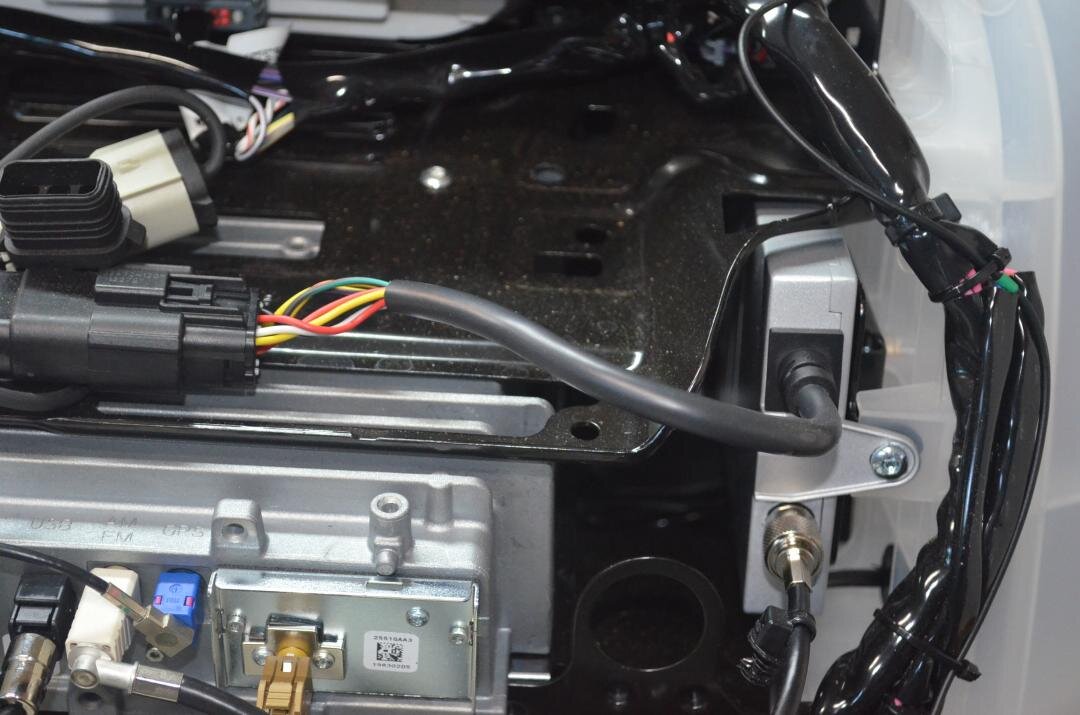

Have no idea which connector it has but here is a picture of it. Don't know if that helps or not?

This is a picture of a 14 did not see yours was a 12 until after it was posted, can't figure out how to delete it. Sorry it is of no help.:gah:

That is the same CB unit as mine on the '12, but it is mounted to the side of the radio. Mine is sitting on the top of the radio. Same wiring & coax connector.
I think it is a TNC connector. But my stealer gives me kind of a blank stare....................
It appears to be a PL-259. Just guessing.
Exactly what I thought!
Never even know what the other 2 mentioned were, until I googled them. I've never seen either one of them used for a OEM CB install????
