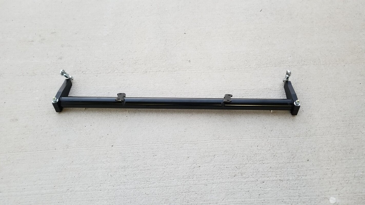

I am actually getting the new anti-sway bar assembly directly from Champion. And they have addressed the lack of lubrication in the new ones by adding grease fittings. I noticed the previous owner must of had a similar problem because it was not on the bike when I purchased it.
When you get it post what you get and any pics you want to share of the process.That way if someone like yourself does a search trying to find info they will have the answer.I was only under Harold's for 5 min in rest area with no jack so I couldn't move around enough to see good enough to really be of help to people.
I sure will. I already have the install directions and it looks simple. 4 bolts fasten it to the frame, and a rod end with one bolt going into each arm.
