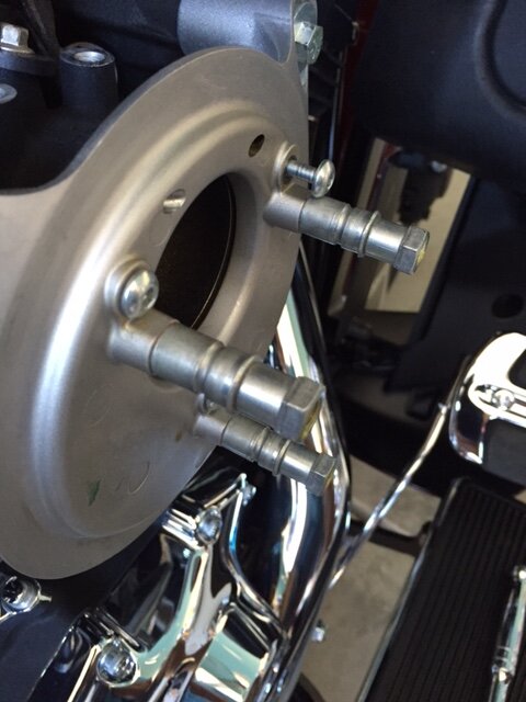

Sure glad I was paying attention to this thread. I took the filter off and found 2 things, small screw was backing out and would have been sucked in that big hole. Next was the two holes will need to be plugged when I install the breather tube bypass. This back plate is the Harley screaming eagle stage 1 filter. JimIMG_5692.JPG
Sure glad I was paying attention to this thread. I took the filter off and found 2 things, small screw was backing out and would have been sucked in that big hole. Next was the two holes will need to be plugged when I install the breather tube bypass. This back plate is the Harley screaming eagle stage 1 filter. JimView attachment 38704
The back plate on my 11 Stage 1 doesn't have those screws. Or the holes where they would go.
Just the two vent holes. The plate is bolted to the heads with with two 7/16 bolts.:Shrug:
