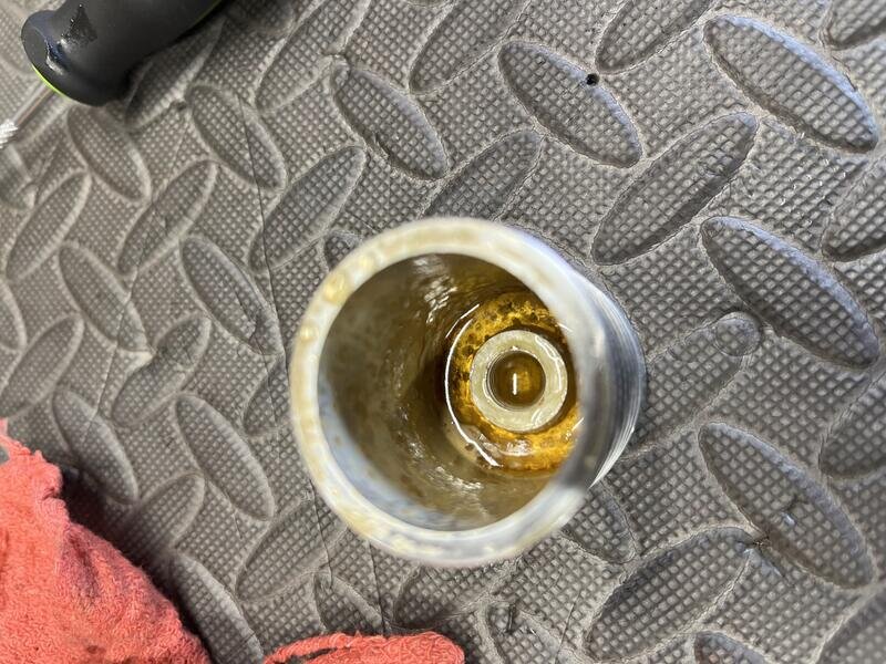

This is why I usually run a filter in the winter. This is condensation from a weeks worth of rides to work (15 miles each way) and one longer ride today. There is more water than oil but otherwise this would go right back into my intake and cylinders. And yes, I get it up to temp on my rides to work but I believe this comes from startup and after shutdown.
This also doesn't count what was in the sponges in the catch can.

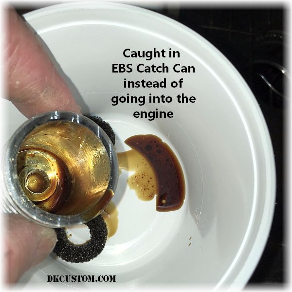

Yep, colder weather makes the mix higher in condensed water. Thanks for posting the photo, glad your Catch-Can is keeping it out of your engine internals.
Cold weather mix-
Warm weather mix-

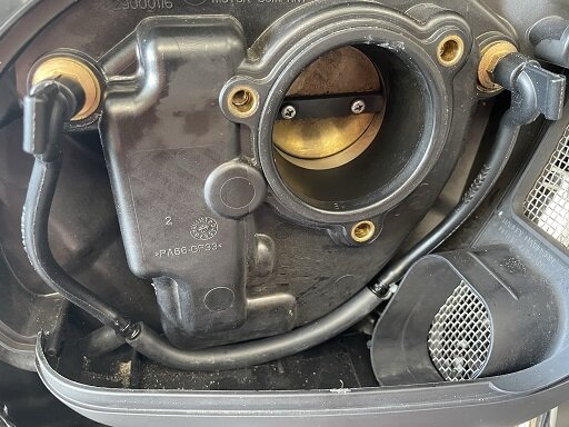

The condensation in the catch can is not moisture that came from the engine.
It is condensation from the outside air.
We really should call them "Condensation Cans", because that is what they are...
When the engine shuts down the can cools off, and moisture from the atmosphere condenses in the can.
If you run a hose that is open at the end, you won`t see any condensation drops on the hose or underneath the machine.
I have been running open end breather hoses on my machines for 34 years without issue.
You don`t need any filter or can on the end of the breather hose.
My M8 breather setup.

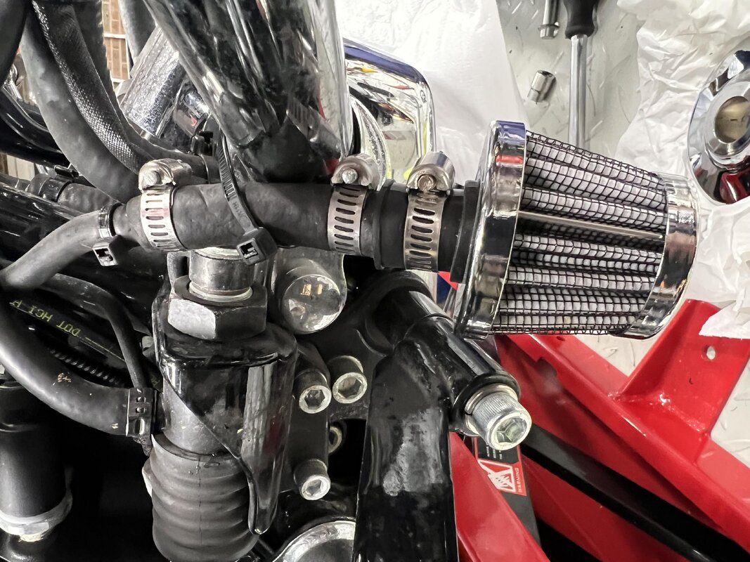

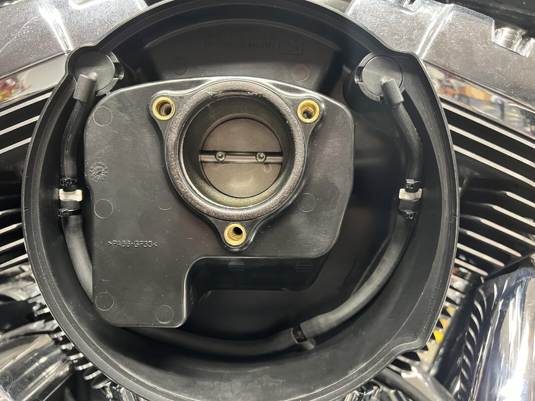

Over the past 7 years or so, I always ran an external breather because the amount of oil that was on my air filters was concerning.
I definitely do NOT want that oil getting into the throttle body and attempting to re-burn. I’m in Pennsylvania and all the bikes I’ve owned (and now the Tri glide) are “recreational” and ridden spring thru Fall, so I will ALWAYS have external breathers on all my bikes.
I highly recommend them & DK has some great kits!
(Last pic showing the filter keeps loading sideways… but the pics show my set up).
I have a few spare filters and clean them every 3-5k miles.

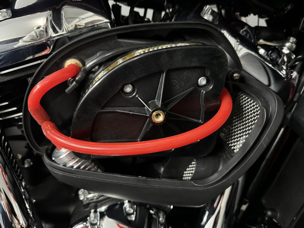

Any thoughts on my setup? It’s a DK catch-can temporarily mounted in the air box, just wedged in for now. It seems to work as intended but I haven’t seen it done before so I was wondering why and if I should redo it. Thanks

Donald.......Welcome to Trike Talk......What trike is it mounted on?.....Your profile says you are looking??..
Hi Donald, Welcome to Trike Talk and your first post
Yes You can run the catch can as is, but it does mess up the air flow in the air box
You can drill a hole in the bottom of the air box to run the hose out and attach your catch can
Welcome to TrikeTalk, Donald! You’re catching all the snot but my thinking is that the nasty vapors are still being sucked into the throttle body. Also, that fancy catch can is too purdy to hide.
There is multiple pictures in this thread, how should be run. Definitely, the catch can needs to be outside the air box, so oil vapor does not reach the engine.
Hey all, thanks for the welcomes. I have it on a new 2023 Tri Glide with 8 miles on it so my thoughts were to leave it in the air box until I figure out the routing and mounting. I hadn’t thought of the vapors just assumed the air filter would clean most of that up and I’d change the filter more often. Now I understand why I haven’t seen it mounted as such before, thanks for the education.
As long as it works, that’s the ultimate goal, so you’re good there.
As far as keeping it there, I can only think the “inconvenience” and the accessibility to easily clean (or drain) it regularly.
… And it’s not that it’s difficult to remove a couple bolts and take the air cleaner lid off… but it’s also making it as convenient as possible to service the catch can.
I don’t use a catch can. I use an external filter. I clean mine every 3-5k miles and just swap out a with a clean filter. (I have a few filters that I rotate/clean & have ready when doing work or just cleaning the trike).
There are 3 reasons to run an EBS:
1. To keep oil out of the throttle body and combustion chambers, and the temp set up you have does that, about 90%.
2. To Reduce the Intake Air Temperature...the temporary set up you have will Not do that. The hot air venting out the top the catch can is still right there, feeding into the intake.
3. To increase the oxygen content of the air going into the combustion chambers. Since the air coming out the breather bolts is lower in oxygen content, and it is still in the air box, the Temporary set up you have does not increase the oxygen content.
Welcome to the forum, and Congrats on your new ride!
