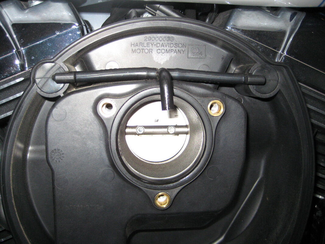

There are two breather tubes that run from each head to a single spliced hose that dumps into the air intake behind the air filter. (See Pic Below) I am really not crazy about these fumes going back into my cylinders. I think they increase the chances of carbon build up, and at minimum must be absorbing space for good oxygen to be mixing with my gas for good combustion.
I was thinking about just splicing the two tubes together and getting rid of the dump tube that is running to the air intake. Has anyone done this and have you had any problems by doing so?
If anyone has a better way to go, I would really appreciate your input.
Thanks in Advance,

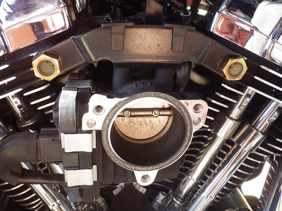

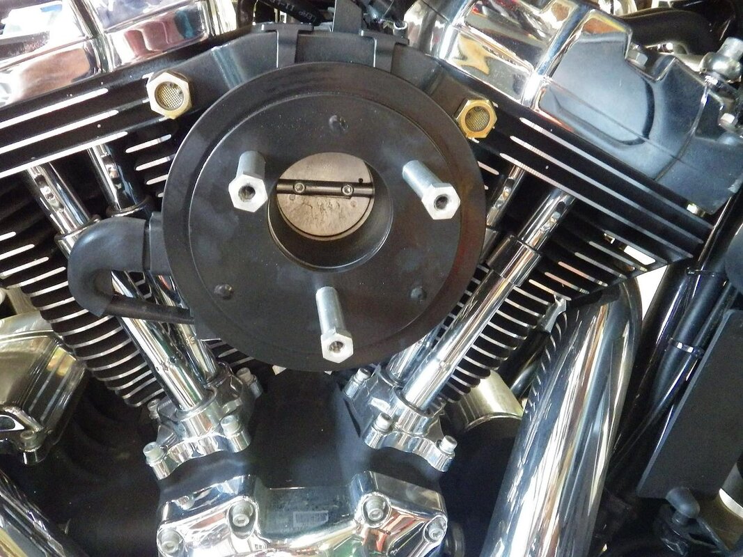

I chose to take a slightly different route. I got a DK 606 air cleaner kit for Touring -Rushmoor, and opted for the Brass breathers. Now I have a stealthy sleeper that breathes like a thuroughbread.

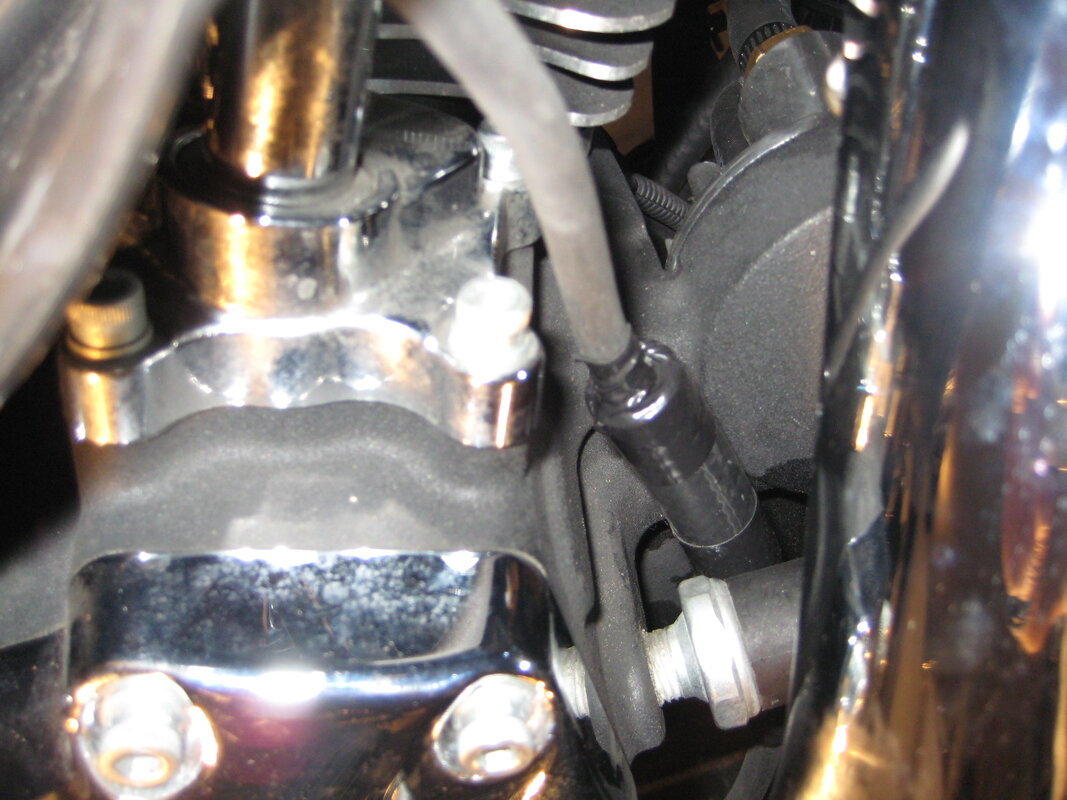

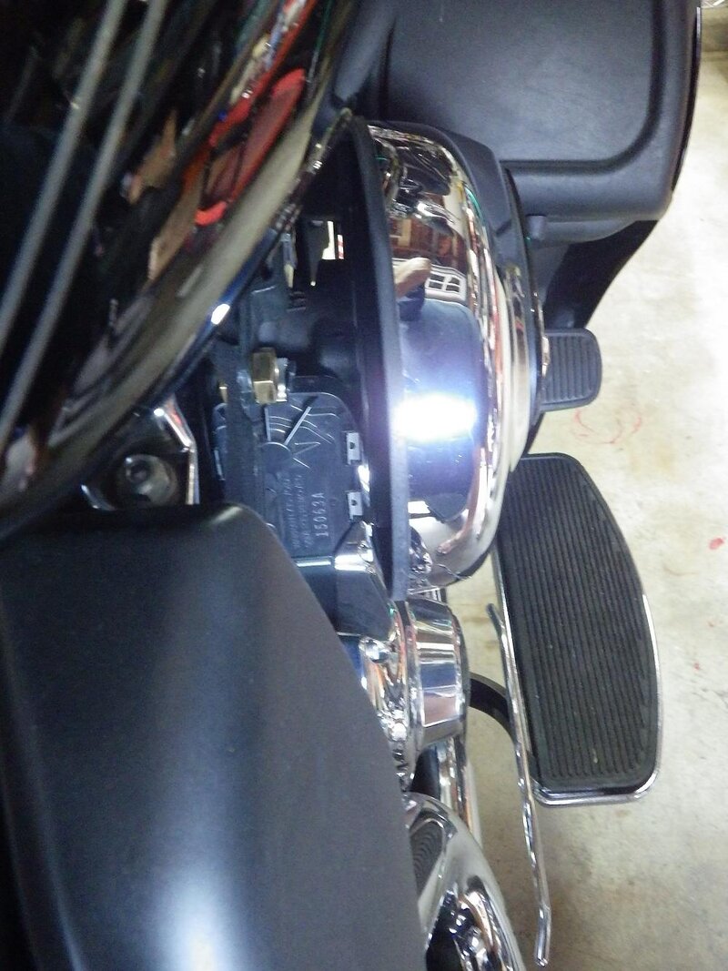

Thank You to everyone. All of you have great ideas, and DK has a couple of really nice solutions. But on this mod I decided to go cheap. For now I have other toys that need to be bought, such as an Outlaw Oil Filter from DK.

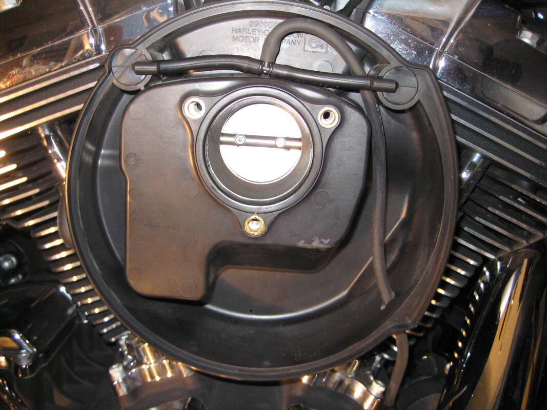

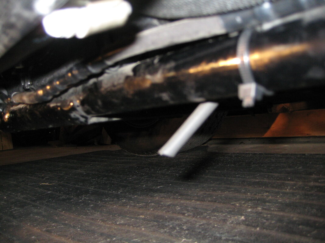

So this is what I did. Went to the local Auto Zone and bought 3 ft. of vacuum tube. Spliced it into the existing breather hoses coming off the heads. Drilled a small hole in the air filter housing and routed the hose down past the oil filter and for a short distance down the inside of the frame. That was it.....cost about $4 for the hose (already had the little plastic connector).
Pics Below...
I did take a piece of larger scrap hose I had laying around and made a heat shield for where the vacuum hose is running close to the engine.
Probably didn't need to, but what the hell :AGGHH:

I would not just connect those breather tubes together..They are sorta vents for the heads...On my 93 FLHS I put a T fitting in behind the carb plate and ran a tube down to exit out...........On my 2015 Tri. I'm not sure if that would be OK or not....Emission problem for those of you in testing states ??? Dave in FL.
These are not vents for the heads!! It is the Crankcase Breather System and the emit "oxygen depleted, oily vapor air to the Throttle Body" and getting this system to exit into the atmosphere instead of the TB will make the motor VERY happy. Cooler/cleaner air with no oily vapor!! One of the best upgrades you can do on your Trike/Bike!!

If you get drips on your floor and don't like them, you can just get a little filter to go on the end of the tube to absorb the oil.
Kevin, how often have you had to change that little filter? Just wondering just how much that filter will asorb.
Butch
On an engine that spits the normal amount of oil, it needs to be cleaned every 7-10,000 miles.
On an engine that really spits a lot of oil, it should be cleaned every 3000-5000 miles.
Does not even need to come off the bike to clean it. Just hit it with some S100 (or soap), let it set for a few minutes, then spray it off (with a garden hose, not a pressure washer). The oil will get washed out, and then it is ready to absorb more oil.
Usually a filter will last for 20-30 cleanings before it actually needs to be replaced.
Great solution! :)
You're right, but before I do I want to put a bowl under the drip tube (for a week or two) just to see how much crap is now not going back​ into the engine. I know I will only get a partial reading because a lot is lost while riding, but it will be some kind of indicator. If there is a OMG amount, I will post a picture ;)

Kevin .... The brass inserts look very cool. Are their small filters behind the "C" clips?
When using the 606 Outlaw with the stock Rushmore A/C cover ... does it stick out further?
Thanks
Bob :D
Yes, they come in Black, Brass and polished aluminum and include two extra filters and different colored screen. Below is from the DK site.
They also come with THREE different color screens. Brass, Copper and Steel. Also included are 2 extra filters.

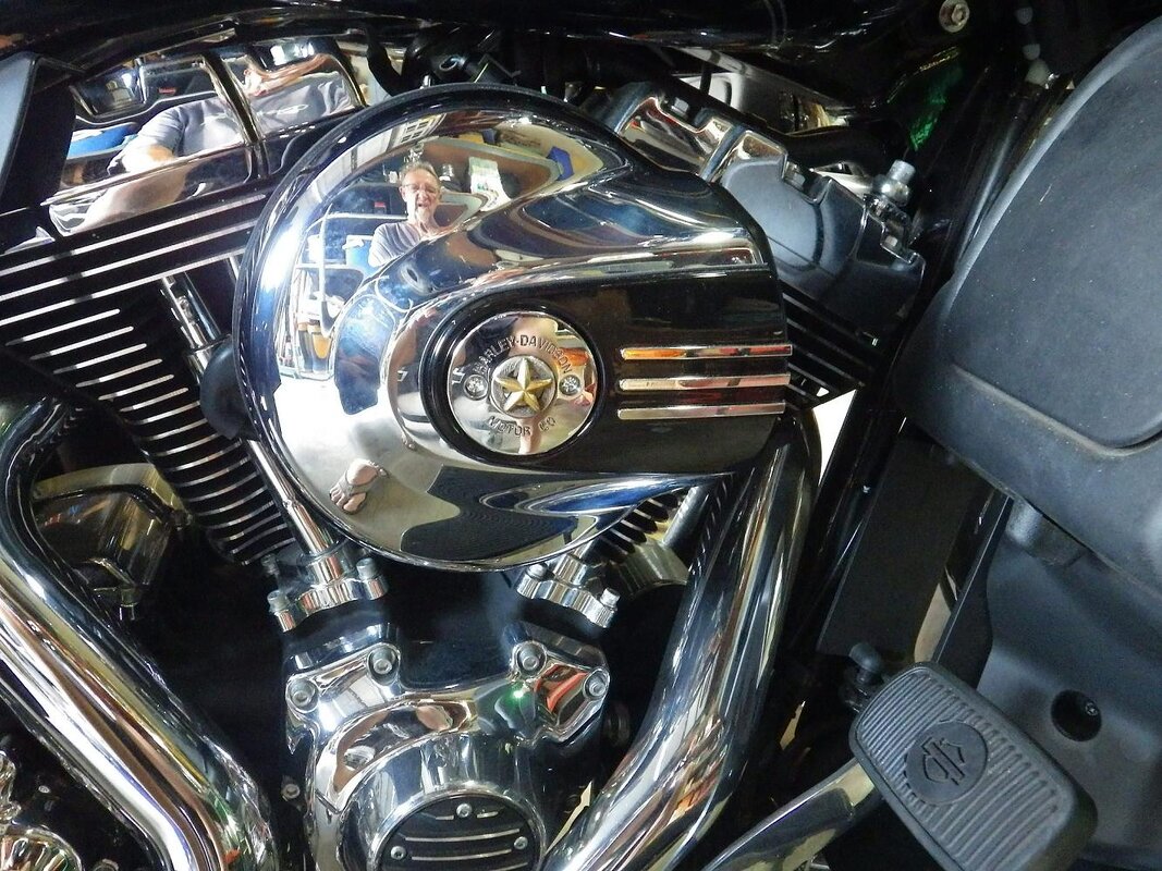

I chose the 606 Outlaw specificaly because I did not want the air cleaner housing to stick out any farther than the stock cover did. Here is a pic looking down while seated. I did not take any actual measurements before I removed the stock air cleaner but my gut seat of the pants or knee on the tank feeling is the stock cover with the K&N on the 606 bracket does not stick out any farther than stock. Mission accomplished :D
