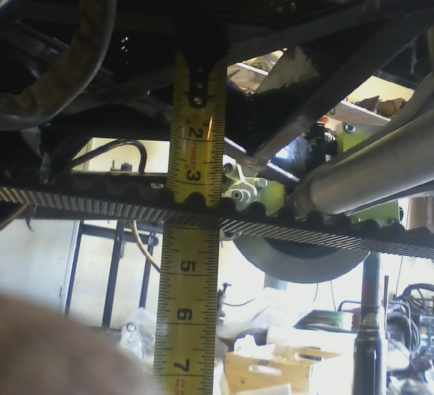

Lift the back wheels off the ground and let the axle hang down, Check the free play (upward belt flex) set at 1-1/2" free play, set the bike down and the belt should have around 1/2" play sitting on it's wheels and that works just fine.

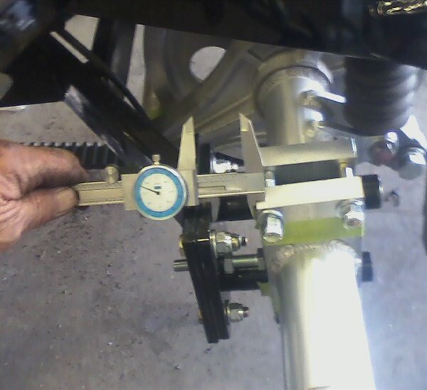

I use a dial caliper on the adjustment plates and mounting blocks to get within a thousands of an inch of true.

d-7-checkingforbeltplay-oneandahalfinchplay_zps58475571.jpg 1-1/2" play when I push up on the belt.
d-8-usingadialcalipertoadjustalighnmentonaxleanddrivepulleys_zpsfd2f8067 (600 x 548) (2).jpg
Use a dial indicator checking each side and adjusting bolts until I get a thousands of an inch, between the two sides for alignment.
Check belt free play again and your done.
