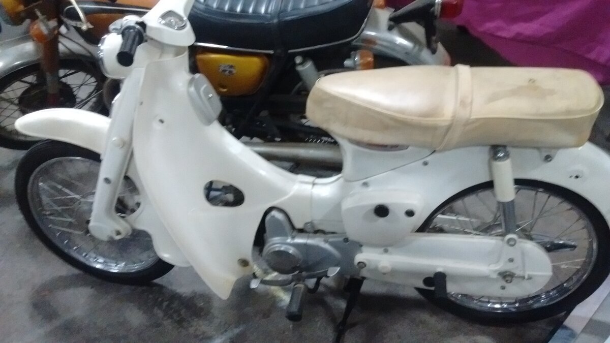

If this is what it looks like now, man, I wouldn't touch this. It looks great.
How does it run
7447,
No that's just a picture, God, I wish I still had it (I was 15/16 yrs old when I owned it (I'm 74 yrs old now!) my mom & dad bought it for me before I even had a license (my mom used to drive me around on it/I'd hop on the back, and wrap my arms around mom, and away we go, into the wild blue yonder! until I was finely 16 yrs old, and got my own MC license...

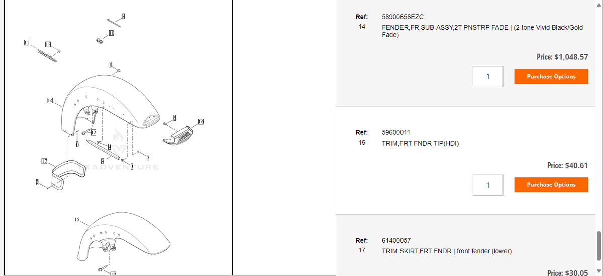

Also, the TriGlide fender has a light up front; the Ultra Limited does not. I like the light and had it on my other Ultras. So, after converting my bike, I ordered that same fender light - guess what, it does not fit
My 24 Tri-Glide doesn't have a light on the fender. Maybe I'd better go up to the stealership and ask them where the hell my light is! LOL
