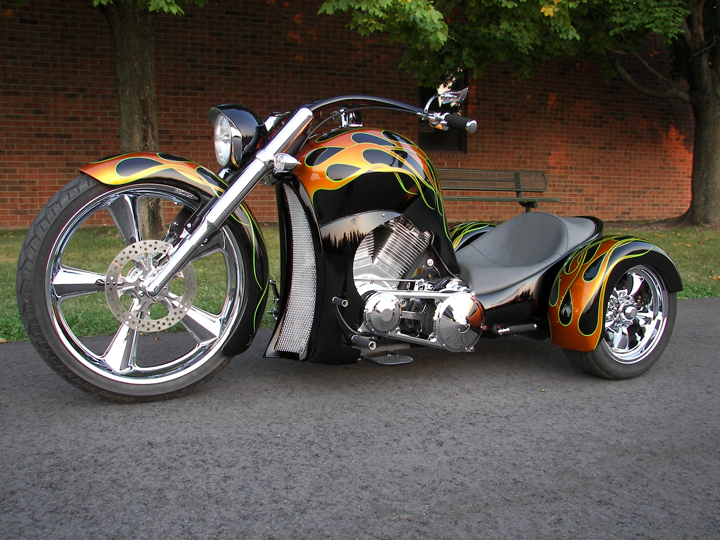

This one looks great and may corner like on rails ... but not a touring trike!! :pepper:
