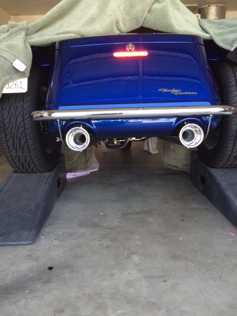

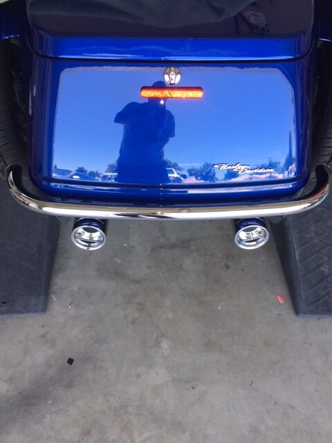

I use a pair of 9" rise Rhino Ramps on the rear wheels only. The front wheel is blocked under a 2 x 6.
Make sure you are riding up the ramp, not backing up the ramp. The trick with these lightweight ramps is to make sure the starting points of the ramps are firmly tucked under the front of the rear wheels. Otherwise, the ramps may start to slide as you ascend.
I also raise the trike suspension to its highest setting. (If your trike setup has this capability).
The lower front part of the fenders will just barely clear the ramp during the ascent, so keep this in mind.
I have not tried to ride up using three ramps on the trike yet.

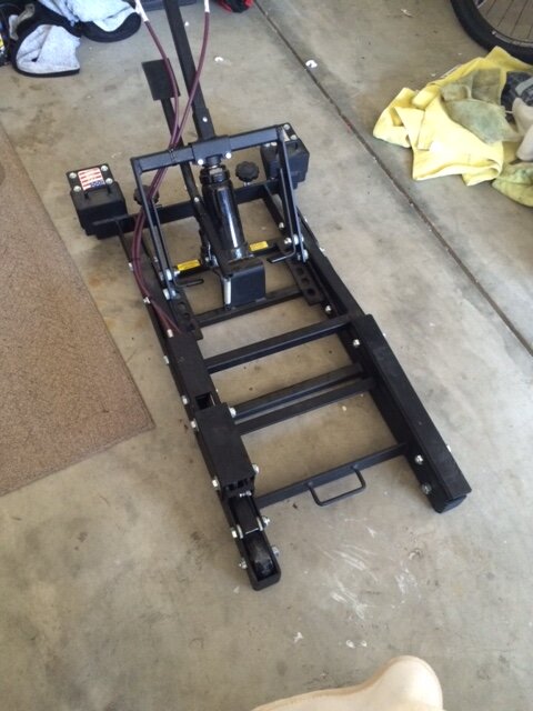

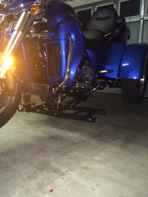

I think I can use my M/C lift to raise the front, Thanks for the Tips. Doc
That will work! I have done that when I need to work on the front end of the trike.
Just be sure to chock the rear wheels real good.ThumbUp

I have this set. They work well for me. I use a floor jack to raise the rear end and put the ramps under the wheels.
When finished, I put it in neutral and give it a little push back and walk back with my hand feathering the front brake (trike off).

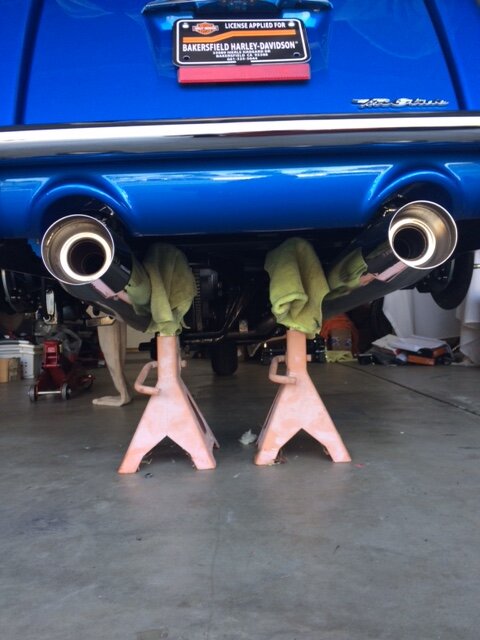

Thanks Bill G, I love pictures and you have taken a lot. Do you have the jack stands in this picture above on the Axle ? Thanks Doc
No the jack stands are on the frames front cross member under the trunk. The trike was lifted with floor jacks under the tie down rings on each side of the axle then the jack stands were set in place. I wanted the rear axle to hang freely not supporting the trikes weight. I was installing rear trike lift brackets and needed the full movement of the axle up and down for the install.
Ride Safe,:)
Bill G
Thanks Bill G Like I always say a picture is worth a thousand words. I did notice not on the axle, Had no idea the Tri could be held up with the cross braces. Again Thanks Doc
