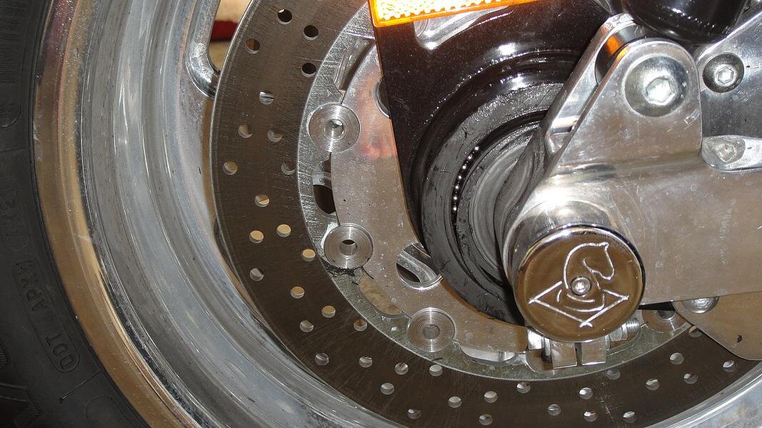

Ladies and Gentlemen, My left front wheel (bearing)...the outer one, NOT the axle bearing has the ball bearings showing. I am not sure the proper name for this bearing, but will try and include a photo of same. I called Texas and spoke with Randy and asked if they had any in stock and he said he would have to order it, but it would be delayed due to the holidays.
Gave be a part number of 6814-2rs. I tried calling several bearing manufacturers and none of them have one matching that part number. I know it needs to be replaced ASAP and we have several parades and "Toys for Tots" runs and cannot drive it like it is. Does ANYONE know where I can secure one or have the correct part number? Thanks in advance....LT
The bearing has lost it's grease seal. Sorry I do not know the number, but if you get it out take it to NAPA they should be able to locate the part number on it or measure it to find one. Good Luck
Try Motion Industries. They specialize in bearings, etc. The part number you have should be sufficient to identify the bearing. Also, try some of the outdoor power equipment distributors - Sten's, Rotary, etc.

Thanks Ted, Gary and Allen for your responses. I have found a few sites offering this bearing, but the price ranges vary greatly in price, not quite sure what's up with that....lol. Some from as little as $18 up to $150+ ...
Any of you know if these are pressed in or will simply dislodge via a sharp rap ? I have a large ratchet socket I was thinking I could use to gently tap on the bearing ensuring no damage to the wheel rim occurs.
Wadda you think ?
Wadda you think ?
Iv'e knocked a few bearings out with a large socket on my trailers' works like a charm.ThumbUp Also you might want to put the new bearing in a freezer for a few hours, It will tap back in a lot easier..

I hope that bearing is loose or located within that black part, to which the caliper strut and shock is attached.

I had one of these bearings go out about six years ago when there was a run on bad bearings. TMS sent me 2 complete new hubs. Just for curiosity, I later disassembled the defective one by welding up a jig and pressing it apart. I did manage to separate it, but I don't believe I could press in a new bearing without damaging it. There are two bearings on each hub. The inner one is the real booger. If you had the bearings, a machine shop may be able to help you. This is one of the weak points of the Stallion. I think if they had continued to build the Stallion, they would have come up with a better design. My 2¥ worth!!!

I am at a stand still...........I have removed the entire wheel assembly...but have run into a couple of snags....I could not break loose the caliper pad retainer bolts,
even after applying a torch to try and melt the loctite holding them onto the rotor ....I decided to remove the assy from the rim and the machine shop was unable to budge the outer seal with the fullest load possible. They decided NOT to try any further for fear of damaging the black housing surrounding them.
I have decided to replace the outer bearing on one, as the shop and two other friends said the other looked fine. Anyone have any suggestions?

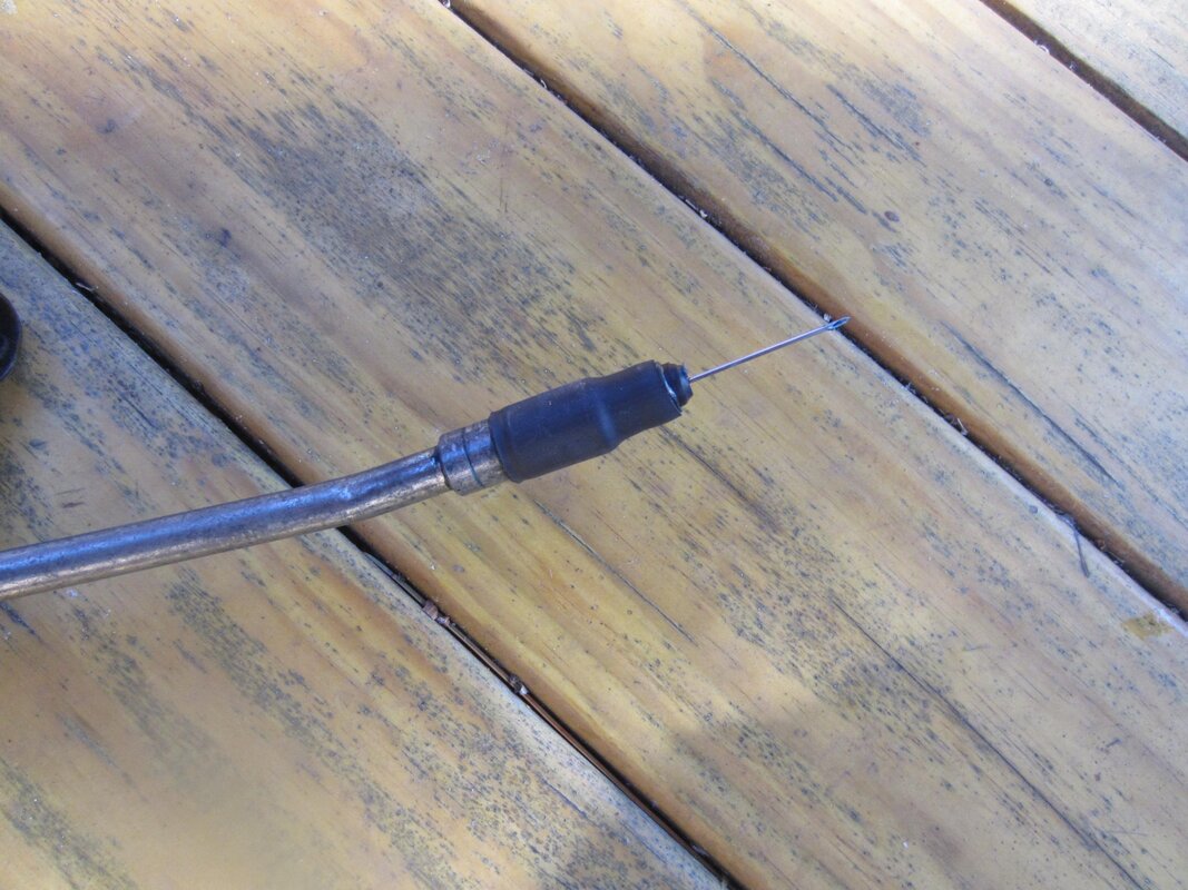

Lubing front hub bearing:
This is a needle grease injector. It is attached to a grease gun with a standard zerk fitting. I have placed heat shrink over the fitting so that grease would not leak out if the fitting is not straight. I made this up to lub the hub bearing. It is a sealed bearing, but with the needle, grease can be injected under the seal. There seems to be some premature failure with these bearings, hopefully periodic lubrication will extend the life of the outer bearing. The inner bearing is not accessible without disassembly, just have to hope for the best.
