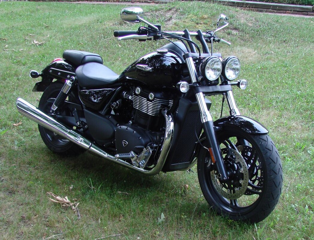

I don't feel my '21 Freewheeler as being any hotter than any other Harley I've owned. It hasn't been a problem for me in 31,000 miles. That being said I'd welcome water cooling if they can do it right. My Triumph Thunderbird Storm had water cooling with a radiator up front and you barely noticed it.
