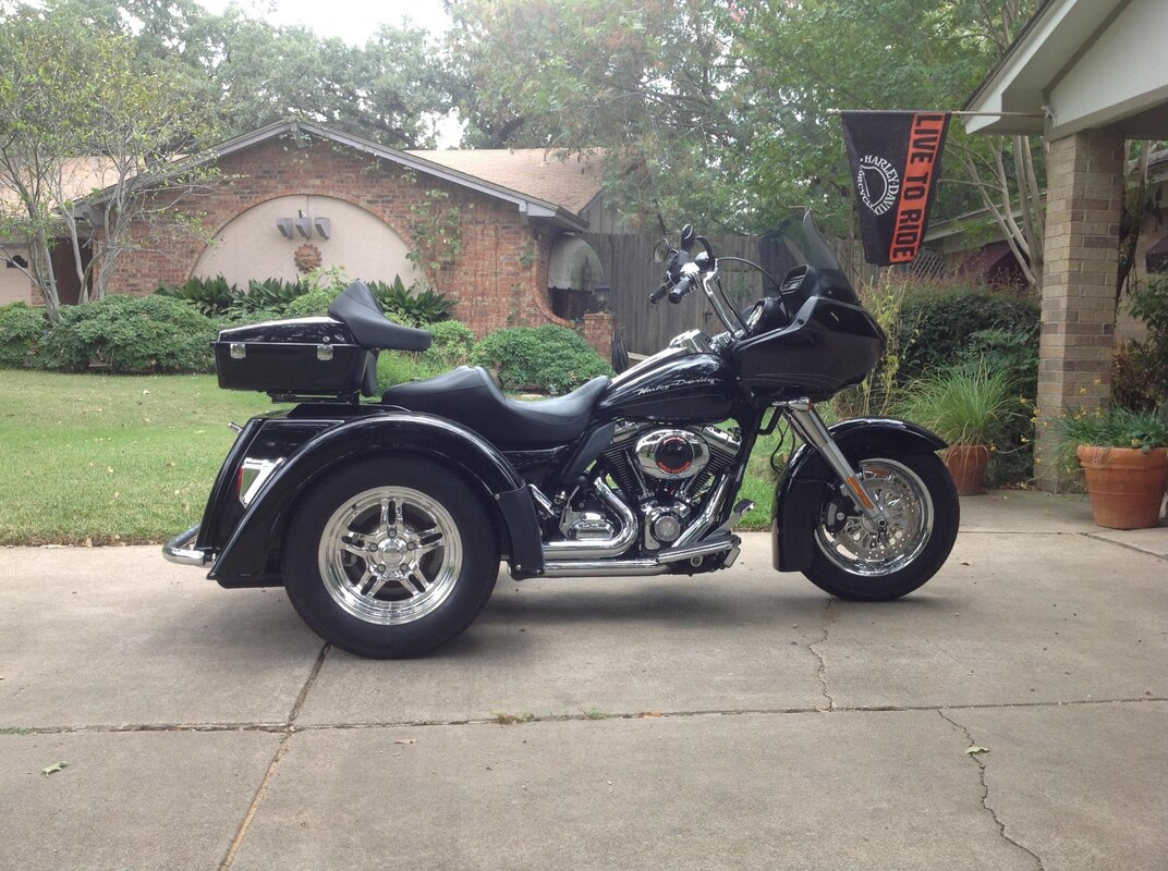

I just ordered a set from Billet Specialties custom made for the Motor Trike. They have a lot of different styles and finishes

The backspace for the Motor Trike is 4.25"
I just ordered a set from Billet Specialties custom made for the Motor Trike. They have a lot of different styles and finishes View attachment 30624
On a 7" wide wheel like you have on your trike,4.25" backspace = +6 offset.
