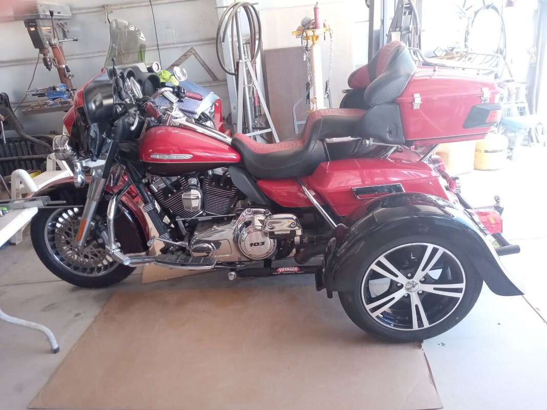

So, I got home from my trip to Colorado, and now it was time to start on the voyager trike kit. put on the rear end first (the new axle and the hardwear for the springs & forks, after I installed the belly pan making sure front to back was the same on both sides, my wife helped me and we rolled the bike in to place and bolted her together. Oh yes I forgot I had to remove the fiberglass fenders to put the tires on. then took mesurments side to side and both sides were 14-1/4", on day two I installed the springs & torked everything down, the next thing is to try it out tommorow, if everything goes good I'll do the wireing for the lights and install the rear splash guard. I think she looks pretty good. Drive side.jpg
Joe, it's been a while since I installed a Voyager kit, like ten years or so, but I remember having to make sure to slide a short spacer board under the rear wheel before tightening everything up so it had a bit of preload on the suspension. Is that still the way Voyager recommends setting up the rear?
