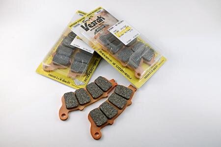

I have tried a number of different pads since 2004 and have settled on these for best performance, stopping ability, cooler running and life span. As I now have a triked bike stopping is of great importance to me & the spouse.
VESRAH JL Front Pads for your TRIKE / Rears are available for a bike...
I still run 41 Psi in the front MPA!!! Have averaged 24K or better on a pair of fronts and they do stop you even with a trailer ..... Loaded !!
GL1800 Brake Pads
These pads are derived from a high performance endurance racing pad compound. Outright stopping power is greatly improved, brake dust is greatly reduced, and these pads will not cause premature rotor wear. The stock brakes work very good to a point, but when you continue to pull harder on the brakes, they don't stop any harder. These pads are very linear and will continue to stop the bike harder (until your ABS comes on, if your bike is so equipped).
(Note: If you can already "skid" your front tire, and feel you don't need better brakes, it's because you have over inflated your front tire... most likely to 40 psi or more. Let the tire pressure down between 32 and 36 psi and your ride quality, safety, and grip will be dramatically increased! Penny-pinching Wingers will tell you to put this much air in your tire to stop cupping DO NOT compromise your safety to save a few bucks on tires!!!)
If you TOW A TRAILER or are OVERLOADED.... (WHO, ME?!?!?!?!?) You BADLY NEED THESE BRAKES!!!
They now only seem to be available thru Traxxion Dynamics :
http://www.traxxion.com/GL1800-Brake-Pads/
$49.95 / you need two pair.... Two Calipers........
And yes as mentioned above when you have the calipers off give them a good cleaning focusing on the pistons and free movement on the slider pins / use a dry teflon or silicone for lubricant and cleaners made for brake parts use. and protect painted surfaces from cleaners and brake fluid. And take your time.... it doesn't take long. If the pistons are stuck soak them with WD40 and you may need to use air to blow them out slowly / covering everything with a towel for protection. New caliper piston seal kits are available. Remember grease in the area collects dirt and road grip and your power car wash blows off the teflon or silicone you applied, now they'll stick again / this is a spring time checking item to make sure everything is free and loose and working correctly. Just some FYI
Almost forgot.... no pliers on pistons or they will be ruined, and no pointy objects on the seals.... they are seals, stop sealing with holes...
