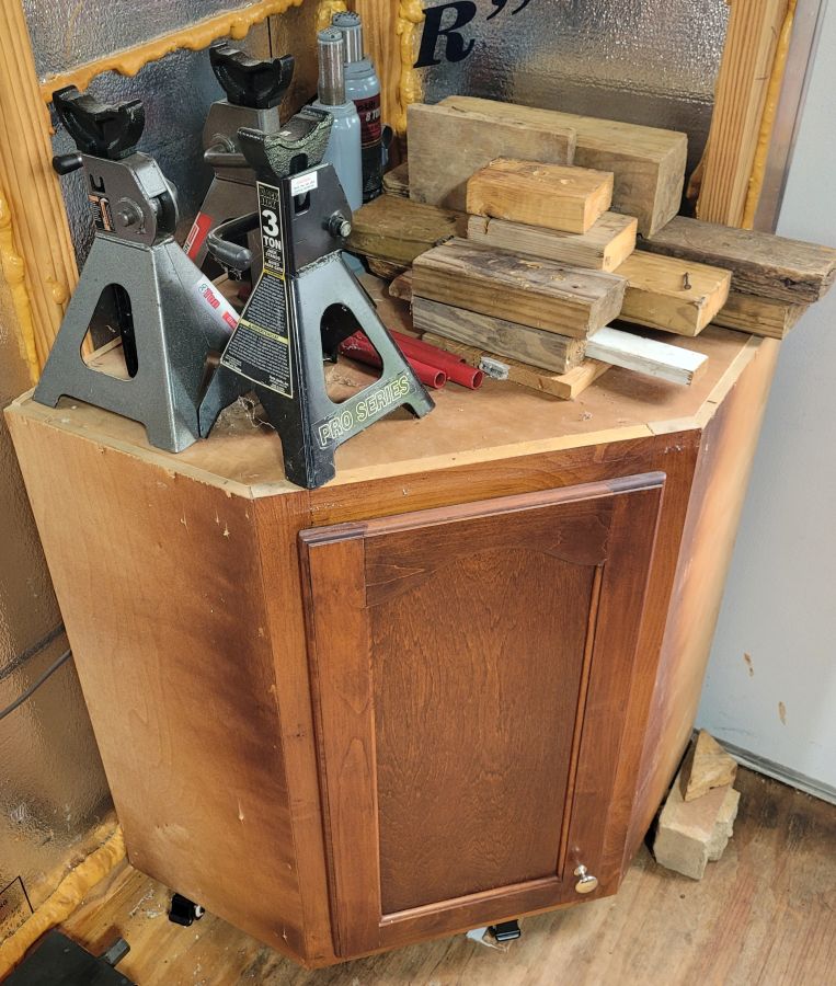

Someone suggested that I get some caster wheels for these two cabinets, so I can move them around in the Bike room, as needed.
Seems like a really good idea, so I just ordered a set of 4 to put on the bottom of one of the cabinets...
...if it works out well I will order another 4 for the second cabinet.
Thanks!

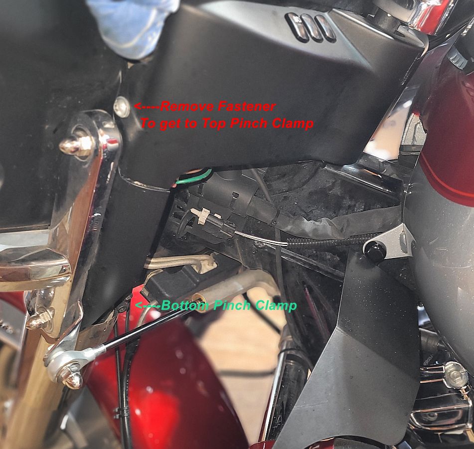

Video on removing forks without touching the inner or outer fairing is still a couple of weeks out.
Here are a few photos showing how easy it is.
This first photo shows the little facia that has the Aux switches in it. There is a fastener on either side that needs to be removed.
The cover does not need to be removed, just pulled aside a little. It gives access to the top pinch clamp bolt.
Then down lower are the two bottom pinch clamp bolts. Loosen all three of them up, and the fork slides out.
Photo from a little further back showing where the 2 bottom ones are.
No need to touch the fairing to get the forks off.
Yep, that is moving at a good pace, but definitely doable. But, get a quote from a dealership and most will add hours onto the bill because they are going to mess with the fairing.
It wouldn't surprise me if some charge as if doing it that way but take a shortcut like you showed. That way they can get done sooner, make a bigger profit, and then get started on the next project in the shop.

Great time saving tip Kevin.

Your Idea worked perfectly! I installed them on one cabinet this morning. Thank you!
Just ordered another set for the other cabinet.
I could have mounted the caster wheel straight to the bottom of the cabinet. However mounting them to the 2x4 block, and mounting the block to the bottom is (1) stronger & (2) gets the top up a bit higher & (3) gives me easy access to the brake lever on each wheel.
First wheel mounted-
All 4 mounted-
Wheeled it over to the front corner of the Bike Room, put the brakes on, then took what was on the floor and put it up top. Have not put anything INSIDE the cabinet yet.
Lots more storage, easier access, and does not get in the way at all. :)
