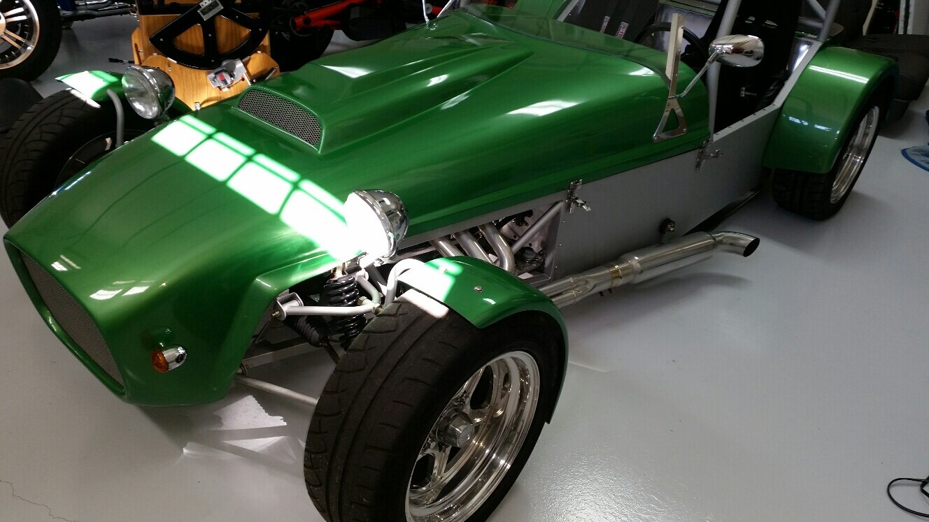

I may not be the best referral for upgrade because I just really like the relaxed ride that my Tri Glide provides. If I want to set speed records, I can hop in my 300hp 1400 pound sports car and blow doors off Z06 vets in the twisties and most straight aways as long as it is not the latest iteration.

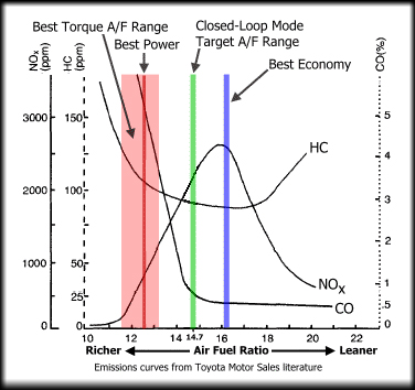

Still stuck @ 44.6 mpg, I reset the fuel ratio on 2 fuel trims {Lambda 1 and 2}
In this chart y'all can see where rich
14.7 is ideal? I set the low side to stay 14.7, working BACKWARDS I set the high 1 point lower. For Lambda 2 I set the low to 14.7 and the high to 13.5. I will give it a few days and miles to see how it affects the MPG and the TEMPERATURE, if I am right I should not see much change, The M8 is an INCREDIBLE engine
