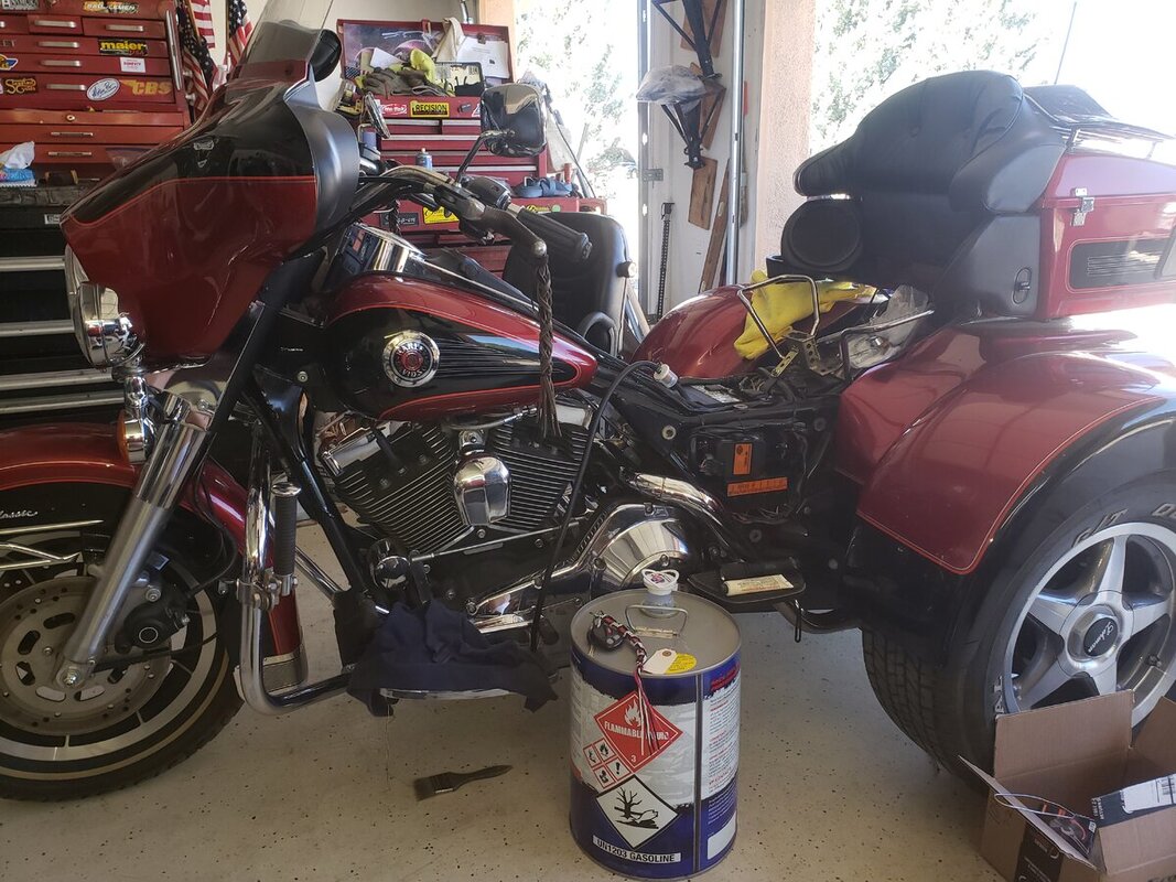

Pic was when I was going thru the Magneti Marelli fuel system to repair leaks and clean it after years of sitting. Used Deoxit D5 on all the electrical connectors and adjusted per manual and all good so far.
