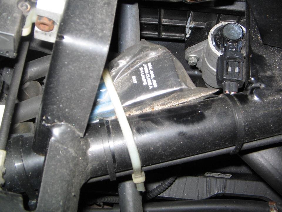

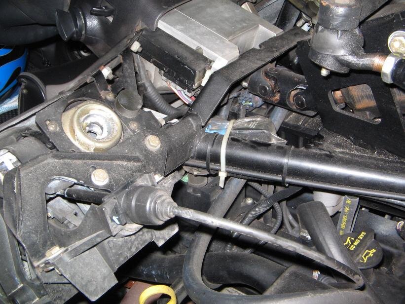

20131023 001.jpg20131023 002.jpgI
Hi I just want to make sure you have the correct part for the flasher. The first picture is the flasher. I put it in a plastic baggy to keep it dry after I replaced it. The second picture shows where I located it on the Stallion. Just above the trans dip stick. It is sticking out of a harness there.

Yep that is the one. Ford Blue relay flasher. I went to O'Reillys and got a replacement.
When I went to remove the Ford relay flasher unit the damn thing had silicone adhesive on the inside of the plug. It was a real pain in the butt to get it off. I even went so far as to mention it to Richard at TBMS and it went right by him. Don't think it registered what I had said.
Same thing. Thanks for the pic to clarify.
