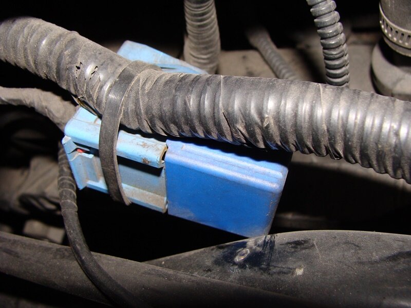

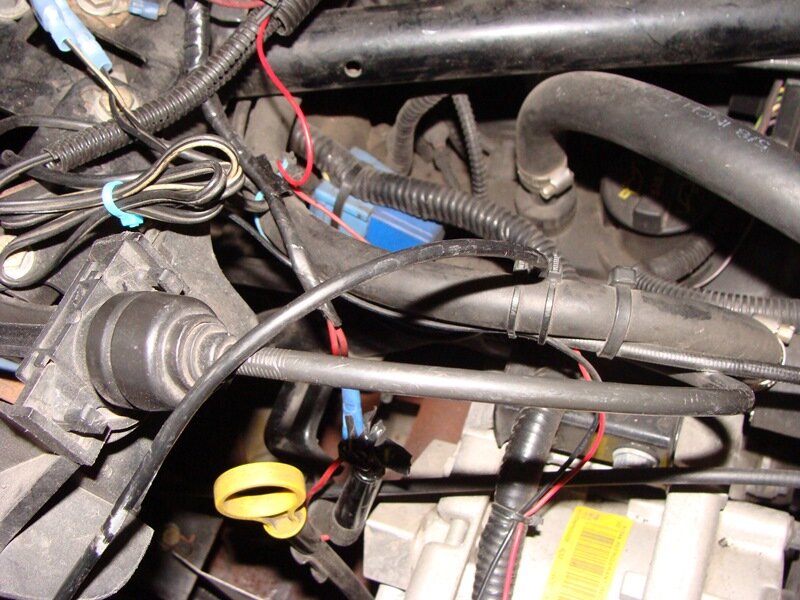

</div>Joe, just happen to have that for your. Just pull out the section in the front, the tie strap part stays.<br />
<br />
<a href="http://www.triketalk.com/forum/attachment.php?attachmentid=22333&d=1410099619" title="Name: Electronic Flasher 004.JPG
Size: 175.1 KB">Electronic Flasher 004.JPG</a><a href="http://www.triketalk.com/forum/attachment.php?attachmentid=22334&d=1410099620" title="Name: Electronic Flasher 007.JPG
Size: 187.9 KB">Electronic Flasher 007.JPG</a>

the plug hangs upside down, the relay is therefor on the bottom with the plug on the top.
if you go thru water or hard rain the plug may fill up with water and ruin the relay.
I took hot glue gun and filled the plug with hot glue, have not had a problem since.
