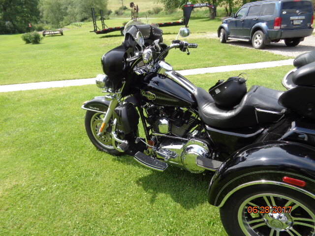

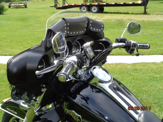

+1 on the 2+2 Wide Sweepers from Khrome Werks these made world of difference for me, 2" higher straighten my back and shoulders. 2" back took care of my neck pain, and the 3"+ width was like adding power steering. Bars a personal thing good luck these worked for me I'm 5'8" 30" inseam. DSC00124.JPGDSC00278.JPGDSC00551.JPGDSC00554.JPGDSC00555.JPGDSC00552.JPG
