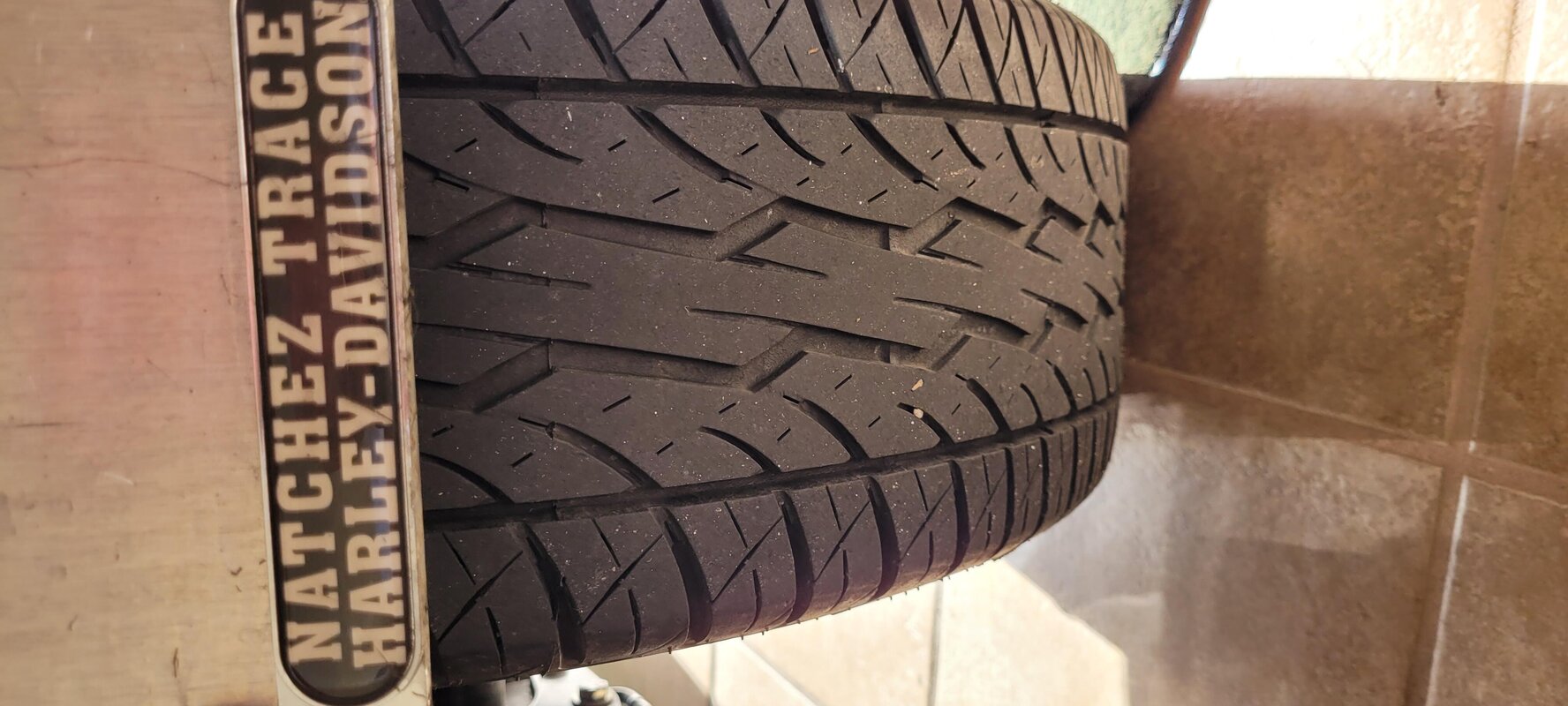

23,000 miles on stock Dunlop, wearing flat, wore looks like about half out L still looks new. running 26 psi. I have search & search to no avail for answers on my Bike went back as far 2012 all talked about what brand of tires & TG wearing on L But, no fix.

I could be way off base here, but remember that you have a differential in the rear. Maybe the right side is the primary drive side and, as such, is the one that gets the acceleration wear, whereas the left would not.....

A friend had a 2015 Free Wheeler it did the same thing he put new tires (good year car tires) on it & ended up trading for a TG. don't know how many miles was on it.

The only/best way to know what’s going on with the tires is to have someone who knows what their looking at..Look at it up close and personal..!
1st Pic. is L 2nd is R the one that is wearing more running 26 PSI. 23,000 miles.
View attachment 110456View attachment 110457
The center tread on lower picture looks like overinflation wear
I just checked my tread depth on stock Dunlops with 19K miles. My gauge readout is in 1/32s of an inch. Left tire reads 7 near center and 9 towards the side.
Right tire 6 center and 8 toward side. So both show 1/16” more wear in center. I always run 20psi.

Are the mfg dates the same for each tire?
I guess I always thought a right tire would wear more quickly on any vehicle with an “open” differential, but this is my first trike so maybe not. It would be interesting if others (with a depth gauge and more than 15,000 miles or so) would measure and compare. Helpful hint. I kept my phone handy while measuring in case I needed assistance getting back up.

Just checked mine. 2021 Freewheeler has 9/32" depth with a depth gauge on both rear tires at 16,500 miles.
