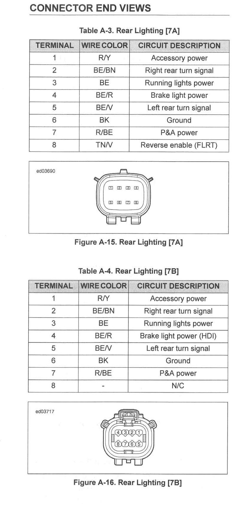

In an effort to keep the stock wiring harness intact and without any splicing or modification, I decided to build an insert harness to power some of the accessories I would like to have on the 2015 FLRT. The insert goes in between the main wiring harness and the rear light wiring harness at the junction located just below the FLRT’s seat (Connectors 7A & 7B on the FLRT Schematics). The following are notes in support of that insert.
Terminal Pin Chart
Terminal 1 on connectors 7A & 7B – R/Y – Accessory Power
Terminal 2 on connectors 7A & 7B – BE/BN – Right Turn Signal Power
Terminal 3 on connectors 7A & 7B – BE – Running Light Power
Terminal 4 on connectors 7A & 7B – BE/R – Brake Light Power
Terminal 5 on connectors 7A & 7B – BE/V – Left Turn Signal Power
Terminal 6 on connectors 7A & 7B – BK – GROUND
Terminal 7 on connectors 7A & 7B – R/BE – P&A Power
Terminal 8 on connectors 7A & 7B – Reverse Indicator Power FLRT (Not Used)
Parts:
HD part number – 72168-07 – Terminal Socket – 8 needed (10 requested)
HD part number – 72469-07GY – Housing (Male), 8 way, Grey – 1 needed
HD part number – 72473-07 – Seal Pin – 1 needed
HD part number – 72169-07 – Terminal Pins – 8 needed (10 requested)
HD part number – 72447-07GY – Housing (Female), 8 way, Gray – 1 needed

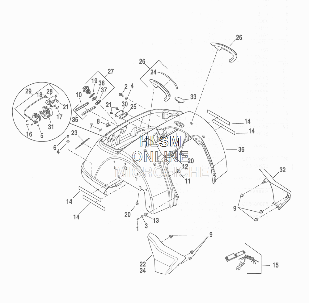

# 30 and 25 is where the wire harness should pass thru the body from under the seat, I cannot believe this is not stock on ALL trikes I aint paying 85.00 for some thing that should already be there, I have a magnetic LED light hung in my trunk
