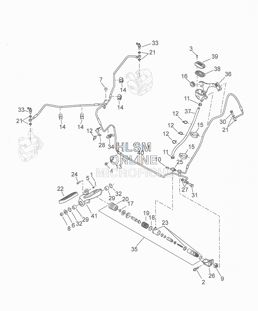

2017 Freewheeler - brake light stays on
Checked out the front switch, took off the front lever, operating switch manually, no change lights stay on. Trying to locate the rear switch. Can't seem to locate it. Any ideas as to its location? BTW, don't know how long this happens, but the rear sockets are pretty burnt. So both filaments must have been on for a while. Again, a 2017 Freewheeler.
Look at your rear brake pedal, now look where the linkage goes to the master cylinder. If you look @ the back side where the line comes out you will see the switch. If you run a diagnostics on your trike you should probably get a B2223 code
See here how to scan your ECM https://www.fuelmotousa.com/p-29661-harley-trouble-codes.html
Look @ #25 here, it is the rear brake light switch
That was it... Thanks for the location
Located the switch, disconnected a wire, and now the brake lights work with the front brake. Yea.
Thanks, if it wasn't for the exhaust pipe, would've seen it.
Anyone know the part number of the switch....
located the switch, disconnected a wire, and now the brake lights work with the front brake. Yea.
72023-51e kit, switch, rear stop lamp
Take note of the letter E on the switch, that tells you HD as updated this part at least 5 times now
