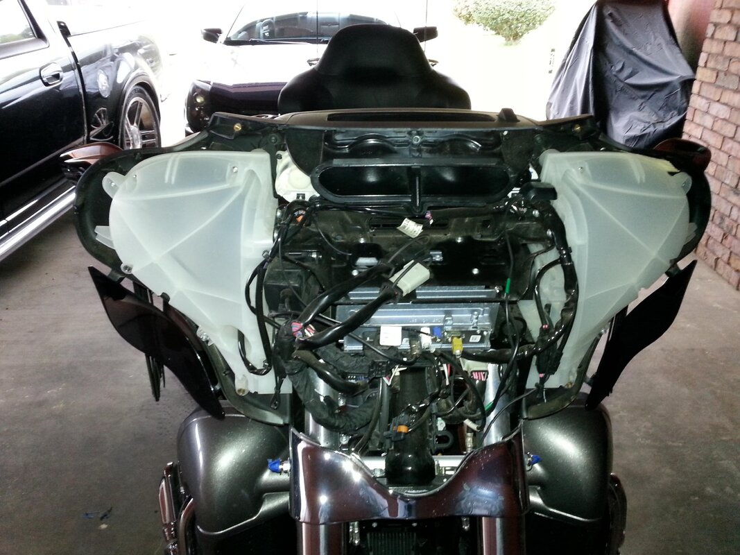

I have a Rushmore Model and installed the 2+2 Narrow Sweepers last spring. I only used extensions for my Hand Control Cables and Twist Grip Sensor (TGS) Connections. I removed the cable keepers for clutch and brake cables which gave me the necessary length to easily remount those stock cables on the new bars. Once I removed the outer faring, I disconnected the electrical connections to the Auxiliary Lamps and Turn Signals and removed them.
With the Inner Faring free, then you just gently lift it a tad upward and tilt it slightly forward. It will stay in place, and I then had sufficient room to remove my bars after properly disconnecting my Switch Controls along with Clutch and Brake Lever Connections. Care must be taken with the Ground Strap when unbolting and removing the stock bars!
As said earlier, this method worked on the Narrow Sweepers Swapout on my 2016 Rushmore Trike.

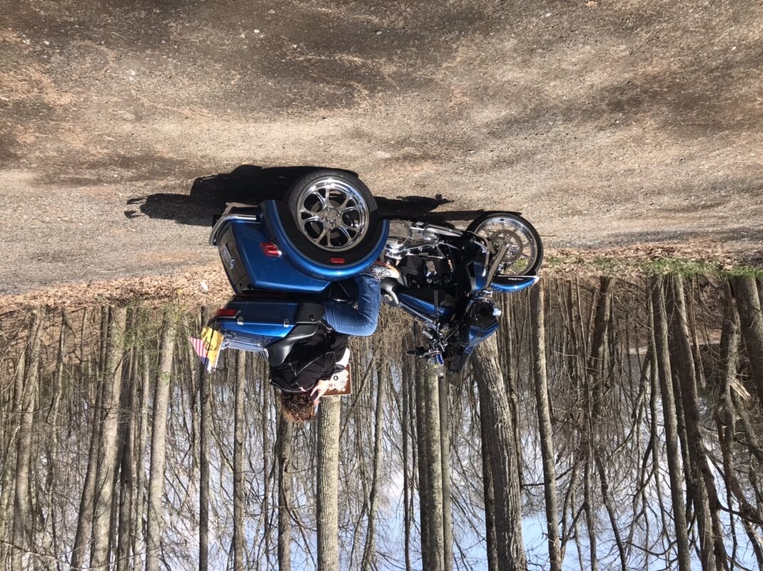

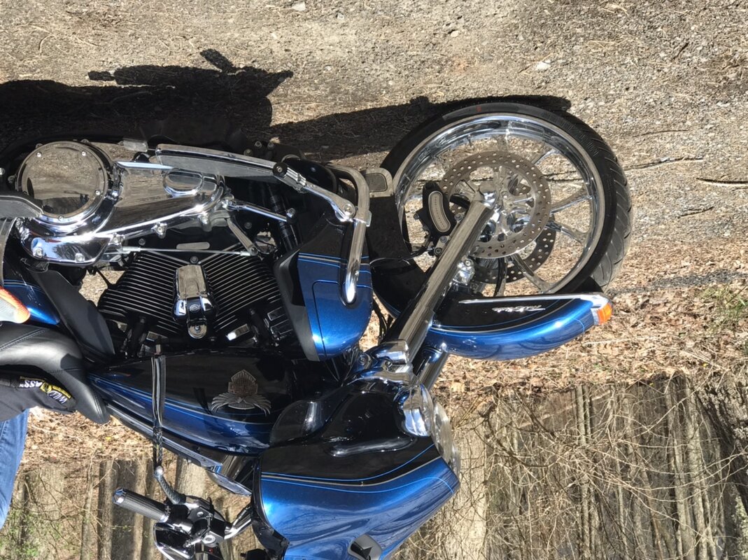

I put the 2+2 narrow sweepers on my 2018 and didn’t change anything, may need to cut some zip ties and reroute some cables but was a very easy install, only cost me 100 bucks for the bars and didn’t need else, I’m not too far away from you longbeard maybe we’ll run into each other some time.

Anyone else notice anything strange in these pictures beautiful Trike possibly one of a kind! gotta love digital cameras. Fred
Yes I do. It's got to be the photo but I don't know how things got f****ed that way. Good eye. I didn't notice it at first.
Must be a EURO trike. They drive on the other side of the road, too.
Good example of what the DI meant when he yelled, "Your Other Right! Numbnuts!!":laugh:
