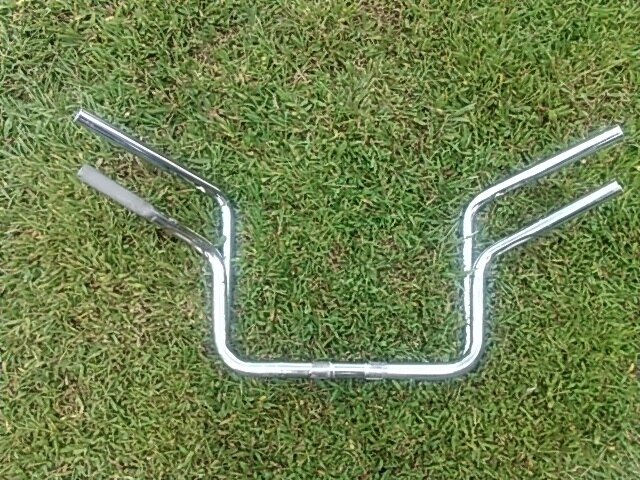

"Has anyone installed the 2+2 narrow sweeps (300519) on a 2016 Tri Glide? I looked on a few web sites and they say it might not fit."
Yes, I installed them on my 2016 about three years ago. Only difficulty I encountered was fishing the wiring through the bars, it was tedious and took a while. I did not use any wire or cable extensions. I did have to clip the cable ties.

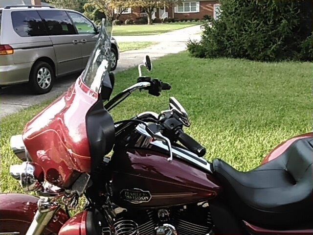

They will fit. I did not need any extensions. Just ran the clutch cable in back of the fairing in stead of in it. Being I’m cheep , I always look for the alternative. Filled the fairing hole with a toy gummy worm looking out as my angle :angel16:
Just put the 2+2 narrow sweeps on my 2020 Tri. All the wires were long enough. The problem I had was the Clutch and Brake line were a little short. Had to run them on top of the bars at the bottom. If you figure a different way of running them or see something I missed. Please let me know. I snipped every tie wrap i could find. The bars are great addition!

Nucseal,
I am in the process of installing these and the brake and clutch lines seem a full inch short or more. How did you get the extra length you need? The wires seem to have enough slack I can make it work, but the hoses are a different story. I appreciate any help.

I'm sure Nucseal will reply when he sees your post. But to help you along I thought I'd jump in. I installed the KhromeWerks 2+2 Narrow Sweepers a few months ago. This video was very helpful:
While it is a different bar the process is still the same. He shows you where there are many cable ties that need to be cut to free up the clutch and brake line. After doing so and a little pulling the clutch fit just fine. The front brake however was still very tight and I pulled on it quite a bit but I did get it to fit and everything line up. Hardly any slack in it but since it is attached to the manifold below the neck it moves with the bars and no stress is placed on it when turning.

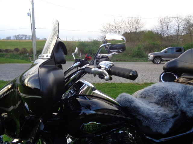

Anyone who put Krome Werks 2+2 narrow sweepers on have a tank lift also, if so were there any clearance problems?
I have both. I am using the 1 1/2" deluxe lift (front and rear) with no problems.
Note: mine is a 2010. Things might have changed in 11 years.
I did not have any issues
I had them put on my 2020 TG. The shop did it. They did not have any problems. They do not have to use any extension wires.
