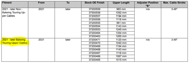

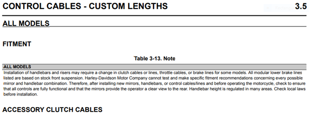

Clutch cable extensions for 2021-22 Tri Glides are available from a couple of aftermarket vendors,but cost around 115.00 for a 4" extension which seems pricey.
Why wouldn't the below work? Aren't "Tourers" with the batwing and TG similarly designed up front? Both have the upper and lower cables routed to the right side. :Shrug:

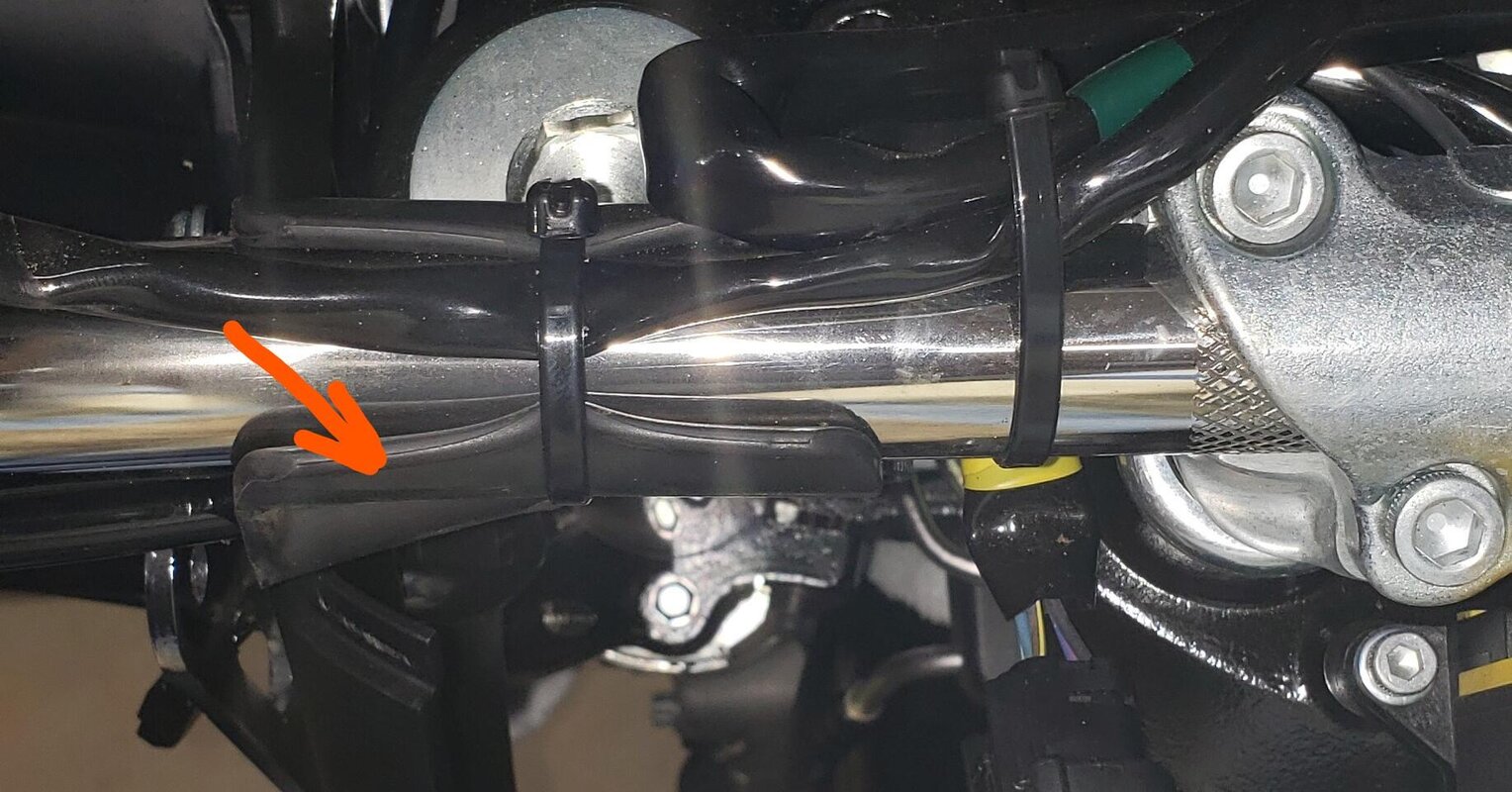

Part # 300519 absolutely works on the '21 TG "without clutch, brake, or electrical extensions". Re-routing of lines is necessary but very doable. In this pic you can see a grommet of sorts that the clutch cable runs through and is tied to the handlebars.

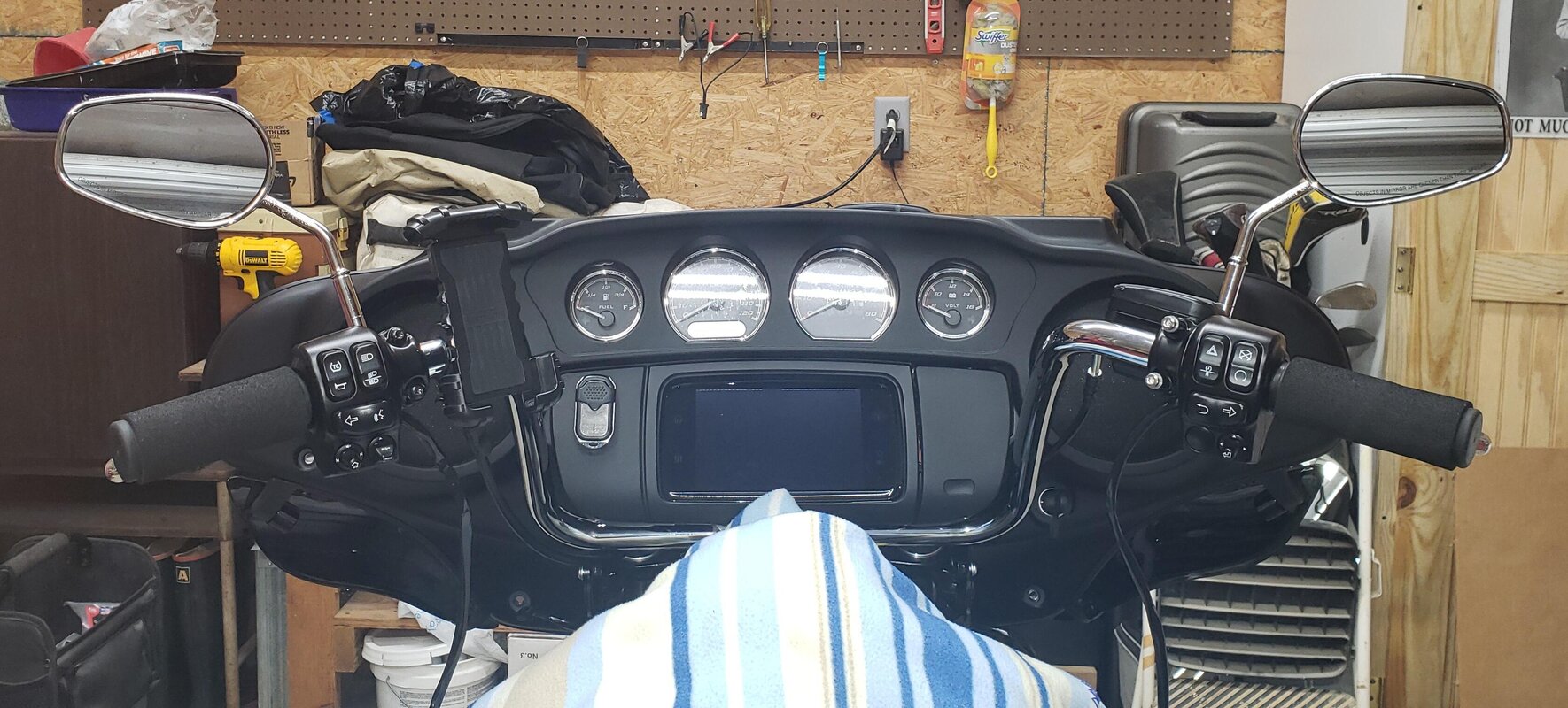

Due to re-routing, I had to modify it since the cable no longer runs parallel to the bars in that area. Still have some buttoning up to do but here's a before and after pic. If you decide to do it yourself, just take your time and pre-think each move. You can do it! :D

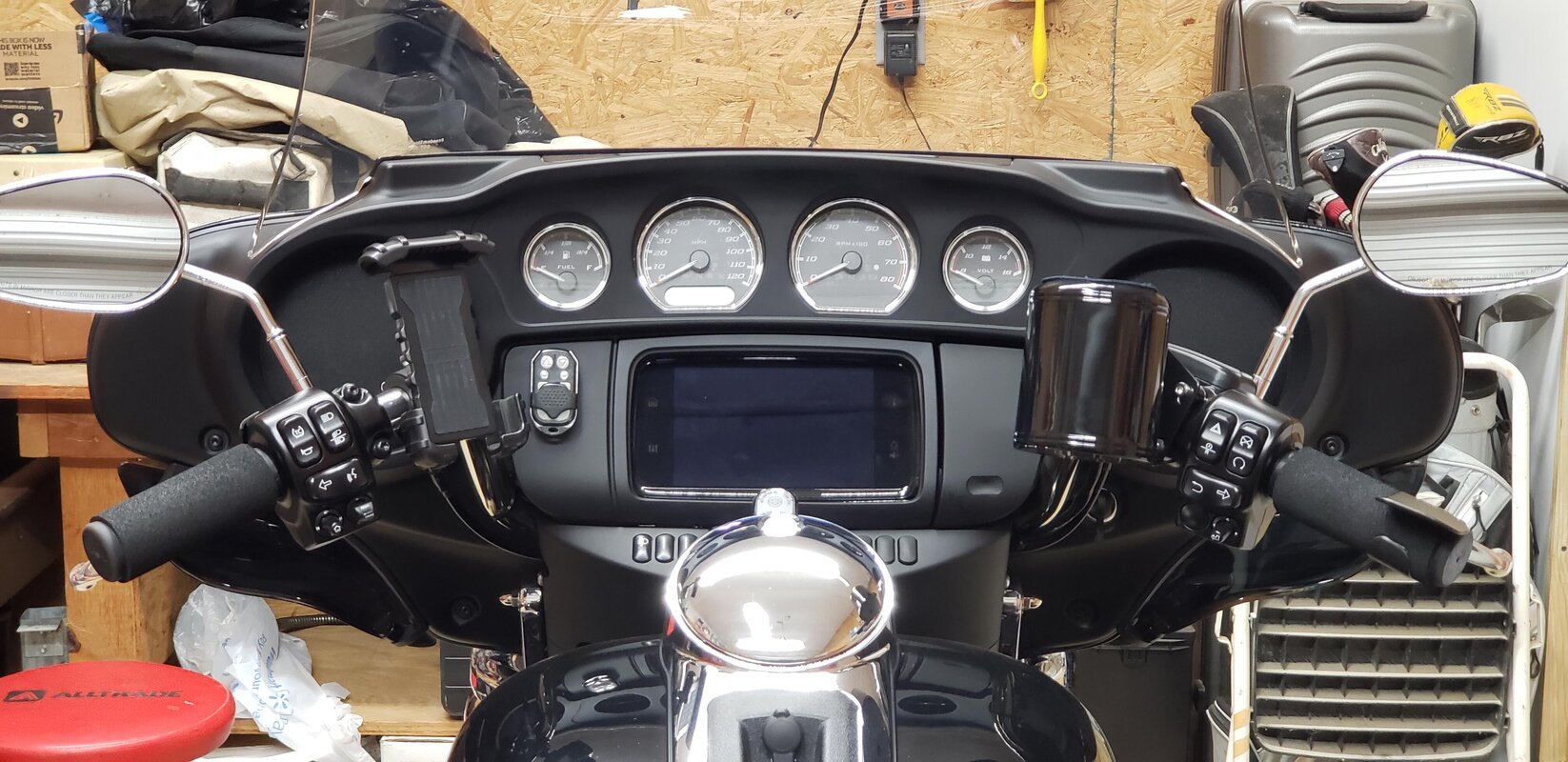

Dealer just installed the 2+2’s on my new 2021 Tri-Glide… while I haven’t had a chance to ride with them yet, just static, they not only feel great position wise, but I can turn the bars side to side with much less effort than the stock setup. Quite noticeable. …And my shoulders aren’t locked with arms fully extended anymore. Can’t wait to try em on the road.
Gotta ask, Jim… your phone holder… I like what I see! Who makes it? :LooksGreat:
I’m already not a big fan of that cubby hole on the right side of the batwing for phone use, and I haven’t even ridden it yet.
Thanks Ron! I like it myself :D. I have the Galaxy Note 9 with the UB Pro Supcase and it fits it perfectly. There is a locking feature that will not allow removal of the phone without unlocking the carrier first. Here's the Amazon link: Amazon.com: Bike Phone Holder, Motorcycle Phone Mount - Lamicall Bicycle Handlebar Cell Phone Clamp, Scooter Phone Clip for Phone 11 Pro Max, S9 and 4.7"- 6.8" Cellphone : Automotive
