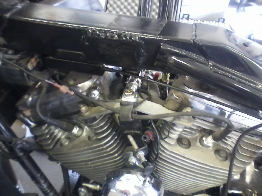

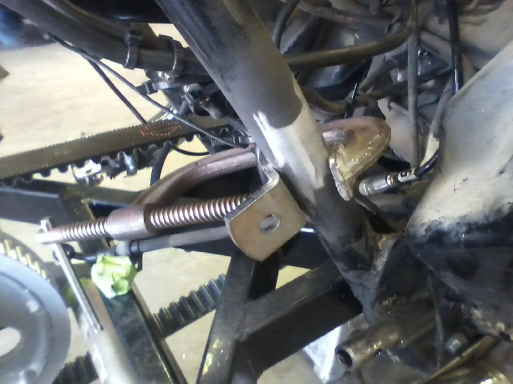

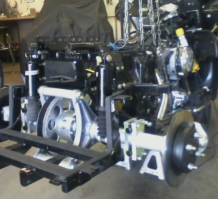

After buying this '87 Electra Glide back in June this year, I have slowly accumulated a few parts. <br />
<br />
Cass County Choppers rear axle kit; MotorTrike rake kit - 6 degree; Champion reverse kit; wheels and tires; and a few miscellaneous parts.<br />
<br />
In true shade tree fashion, I built a Gantry Crane and bike stand. <br />
<br />
After a Colorado vacation, another right knee injury, and now cataract surgery, I finally put the bike up on the stand yesterday in balmy 96 degree September weather. <br />
<br />
I am not going to detail the tear-down -- all routine up to now. <br />
<br />
<a href="http://www.triketalk.com/forum/attachment.php?attachmentid=39431&d=1474399354" title="Name: Gcrane.jpg
Size: 462.2 KB">Gcrane.jpg</a><br />
<br />
<a href="http://www.triketalk.com/forum/attachment.php?attachmentid=39432&d=1474399603" title="Name: build3.jpg
Size: 85.6 KB">build3.jpg</a><br />
<br />
<a href="http://www.triketalk.com/forum/attachment.php?attachmentid=39433&d=1474399605" title="Name: build2.jpg
Size: 91.1 KB">build2.jpg</a><br />
<br />
<br />
By the week-end I should be ready to install the rear-end.

Update on Shade Tree Build
After planning a fast and simple shade tree trike build, I am here in December and still not on the road. <br /><br />
<br /><br />
My first major delay came when I was trying to remove the swing arm pivot shaft. Of course, the manual says to simply remove the nut and lightly tap the shaft our. Well, the 1987 Electra Glide has a two piece pivot shaft with one side screwing into the other side of the shaft about half-way through the mount on the back of the transmission. Those two pieces were rusted together and it took major force to break them apart. On each side of the shaft there was a rubber coated bushing. That bushing was rusted to the actual pivot shaft on each side. There was no way to get either penetrating fluid or heat to the area. <br /><br />
<br /><br />
It took brute force to get one side of the shaft to pull through the actual swing arm bushing. The other side would not budge even when struck with a heavy metal mallet.<br />
<br />
My concern was that I was going to gall and/or break the transmission mount.
Finally, I fabricated a press from an old bearing puller. I put the press between the frame and the swing arm and pushed the other side of the shaft out. No damage done to the transmission housing, thankfully. <br /><br />
<br /><br />
In replacing the pivot shaft I went to a one piece shaft. For reasons unknown to me, the shaft on the '87 model is 41/64". The bushings in the rear end kit are for a 3/4" shaft. Lost some time there while Cass County Choppers machined bushings to fit the '87. <br /><br />
<br /><br />
During all this build, my business has been very busy and I have had little free time to plan and wrench. Every time a I start to work, I have good intentions to take photos and update regularly.<br />
<br />
Then I find that I have completed a stage of the build and have no photos. <br /><br />
<br /><br />
Finally did get the rear end installed and am waiting for the body kit to ship.

<a href="http://www.triketalk.com/forum/attachment.php?attachmentid=41270&d=1481606130" title="Name: e-4-unfinishedweld_zps9f63a3e5.jpg
Size: 83.4 KB">e-4-unfinishedweld_zps9f63a3e5.jpg</a><br />
<br />
The champion upper motor mount comes with metal stiffeners to go right into your current mounts and has a heavy duty stiffener. Newer bikes don't need one but yours will. <br />
The kit comes with an epoxy to attach the heavier plates to your frame, I welded mine to the frame. ( watch your heat, enough is enough and too much is to much)<br />
About a 100 amps on farmer rod, bout the same on wire feed? I don't remember for sure.<br />
( keep your ground wire as close to where you are working as possible making sure you wont strike an arc through any bearings.<br />
<br />
You can see an unfinished weld on the mounting plates<br />
<br />

You can see the end of my exhaust in the picture, I eventually cut off the flare, ( they are a pain in the butt compared to the newer style Harley pipes.) welded a joint and used regular car muffler clamps. I like it better than Harleys original flare/ clamp system.<br />
Champions Bassani Mufflers come with S pipes to clear the axle, I had to shorten the pipes a bit anyway.<br />
<a href="http://www.triketalk.com/forum/attachment.php?attachmentid=41273&d=1481608246" title="Name: d-11-readytomoveontobrakelines_zpsc11be625.jpg
Size: 160.0 KB">d-11-readytomoveontobrakelines_zpsc11be625.jpg</a><br />
<br />
Positioning and welding body mount for rear body framing after mock fit up.<br />
You can see the saddle bag mount on the lower right side of picture, I cut it off because it will make setting he body down a real pain and scratch hell out of the paint.
