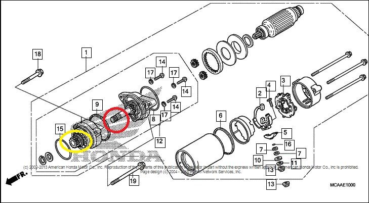

I may be out of line or dead wrong here, but I'd strongly suggest removing the starter & verifying it's actually turning where the "magic happens" (the end gear section you see with the starter removed from the rear case).
There is an internal gear reduction & splined shaft that slides into the end of the stater gear that actually turns the motor (see attached image circled in red). Seen starters "go bad" a few times for various reasons. The round gear inside the case you see with the starter removed (just off to the side) is part of the reverse mechanism & doesn't have any bearing on the motorcycle starting (circled yellow part is what engages the reverse).
THAT IS WHAT I WAS MISSING!!! I was sure I'd seen something else but when I went looking again the obvious evaded me "AGAIN". :xzqxz: That piece is the External one that just may be the real culprit!
