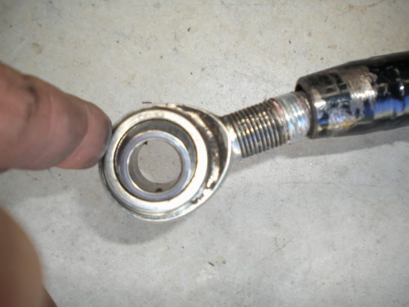

Sounds like a possible tire problem, maybe even loose lug nuts, BUT might be more...The MT kits have Heim joints on either end of the bar that wingnut mentioned. Check both ends...also be sure and check the six Heim joints, both front (one) and rear (two) on the right and left ladder bars. The Heim joints have been known to strip out on the ladder bars (see pic below)...that actually sounds the more likely problem than the torsion bar (which is actually an adjustable centering bar). There is a lot of torque placed on the front Heim Joints and sometimes the threads strip letting the rear end shift.
