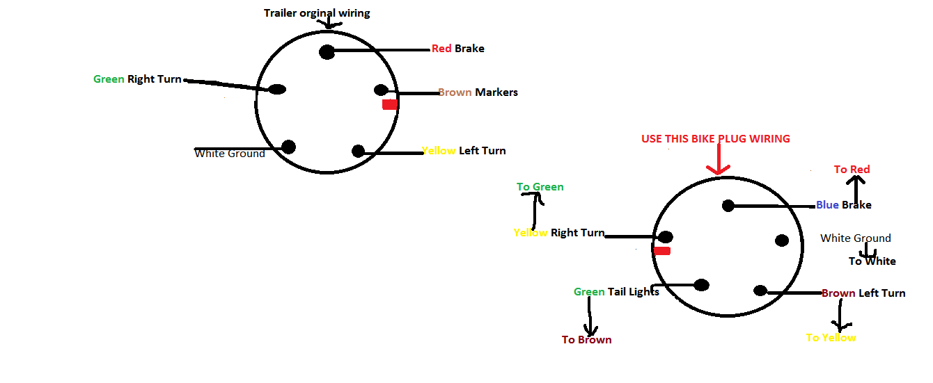

I used posi-tap wire connectors to wire my trike to the trailer receptacle. My trailer uses a 5 wire round plug. My trailer has separate brake and turn signal lights.

You need a 4 to 5 wire adapter and I recommend a powered one.
Your trike has a 4 wire system: ground, running lights, stop lights and right turn and left turn. The stop and turn lights use a double element bulb.
From what I can understand you have a 5 wire trailer: ground, running, stop lights, right turn and left turn. The turn lights use different wires and bulbs than the stop lights.
The use of a powered adapter will take the load of the trailer lights off the bike and put it on the adapter. You can find all you need in plug and play kits here - http://electricalconnection.com/. If you have questions their customer assistance was very good when I called them.
