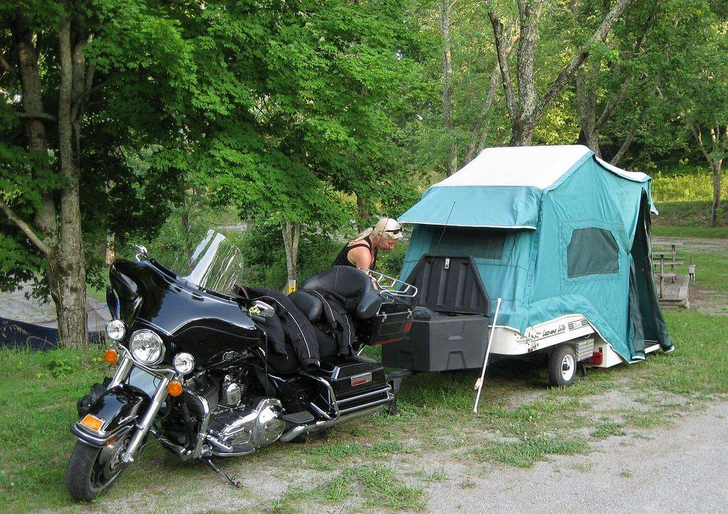

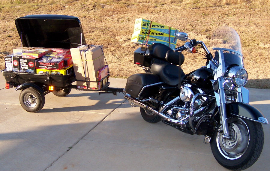

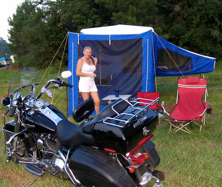

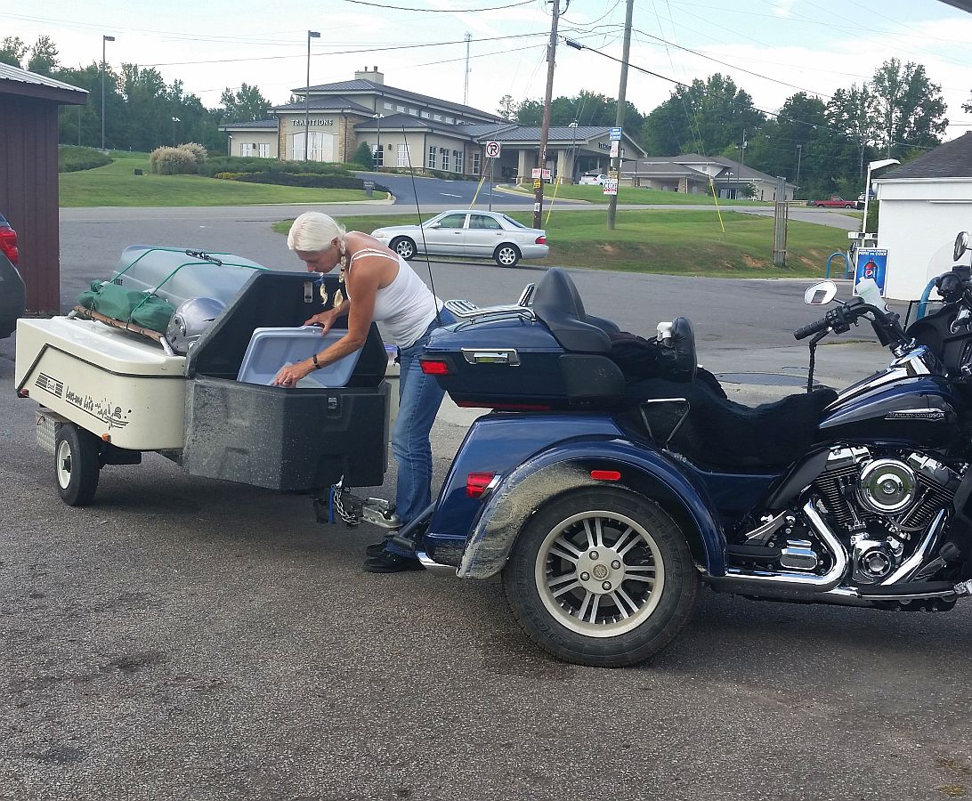

Here are a few photos from over the years-
