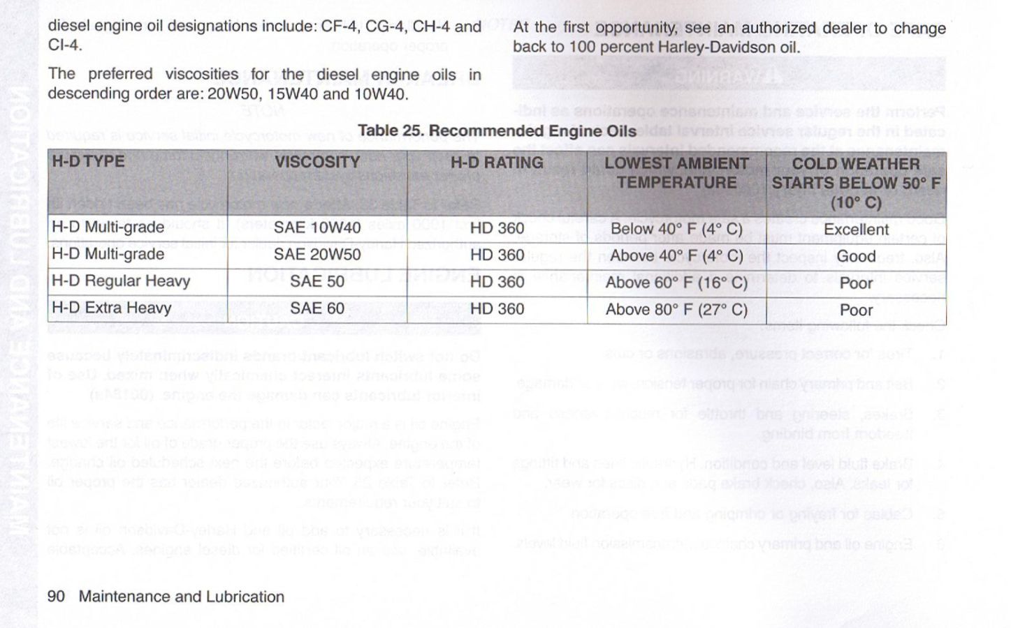

Old oil is losing it's viscosity, or Incorrect viscosity for temperatures you are riding in.
In the HD Owners Manual the following chart appears-
If you are riding in temps of 60* or higher, the best viscosity, which will result in the least amount of blow-by, is straight 50 weight.
20-50 may have just as good of lubrication qualities as straight 50 weight, but IT WILL produce more blow-by at temps of 60 degrees and higher.
If you are riding in temps of 80* or higher, the best viscosity is straight 60 weight.
IT WILL produce LESS blow-by.

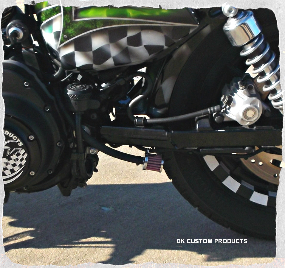

Alternatively you can use the Discrete Breather System to route the hose down to a filter toward the bottom of the bike...
or to a "catch can" which will hold the oil and need periodic emptying.
Two examples of the many possibilities with the Discrete Breather System-
