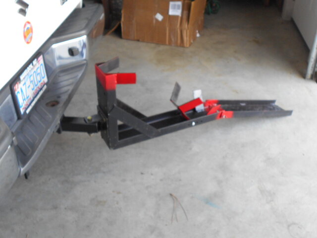

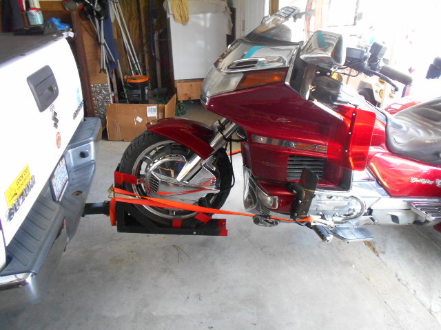

However, I just changed over to using a Insta Motorcycle Tow from BillyBob1.com. Really easy to use - just run it up on the removeable ramp, use one short tie down secure tire to front of the "tow" and use one long tie down that runs from one road peg and round the front of the "tow" and over to other road peg and ratch down. Again no compression and no movement. Best part is the reduction in gas mileage since the InstaTow weighs in at only 48 pounds as opposed to my 1,000 trailer.

I used it a couple of days ago to tow the 1800 to my mechanic who lives about 75 miles down the road. (Had an electrical problem I couldn't resolve.) No problem with the transmission as I towed it in neutral. And, I took a 125 mile ride yesterday and could no feel any difference in the trike.
But it tows really easy and since it has a swivel point it makes taking corners very easy. Only negative thing I can say about it is that I had it set at the lowest set (got 4 settings) and that left it low enough that I scraped the driveway going and coming back from Richlands. And the one at the Subway in Trenton too. Will raise it one setting up next time I have to use it.
Did notice I used slightly less than 1/4 tank of gas than when I would take a motorcycle down on the trailer. And I was cruising at 65 MPH as opposed to my usual 55 MPH with the motorcycle on the trailer.
And as Ron, BillyBob's, mentioned to me when I was quizzing him before I ordered -- once you get to your destination you don't have to worry about that darn trailer you've been towing.
You just unhook the Insta Tow, put it in your vehicle, and go do what else it is you want to do.
Forgot to mention that by adding a piece of angle iron, less than the width of the towing vehicle, to the tow post and adding eye bolts on the end it can tow 2-wheelers. Ratchet straps from the eye bolts to the center of the bike stabilizes it, keeps it upright, and allows it to turn on the pivot point and not the bike.
Directions provided with product instructions.
