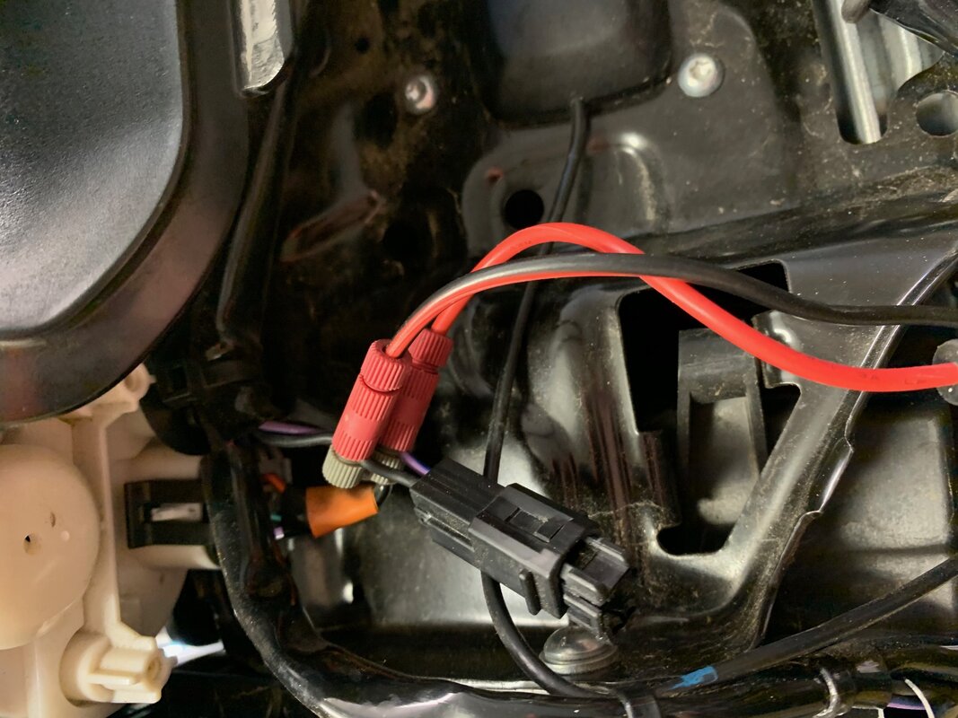

I grab power for my Garmin GPS here. It is on the top right side of the fairing. It is an unused plug which provides switched power. Violet is hot and black is ground.
For some reason the photo is rotated 90 degrees left. The original photo I have is correct but when I upload it here it changed ????
Ultra, where did you get the tap connectors? They were in the wiring kit that came with the power assist running boards that I put on my Jeep Wrangler, and I love them. I just could not find out where they came from.
Thanks
Thanks
They are Posi Tap brand connectors and are the best imo. Could not find locally but was able to get them from amazon.com
